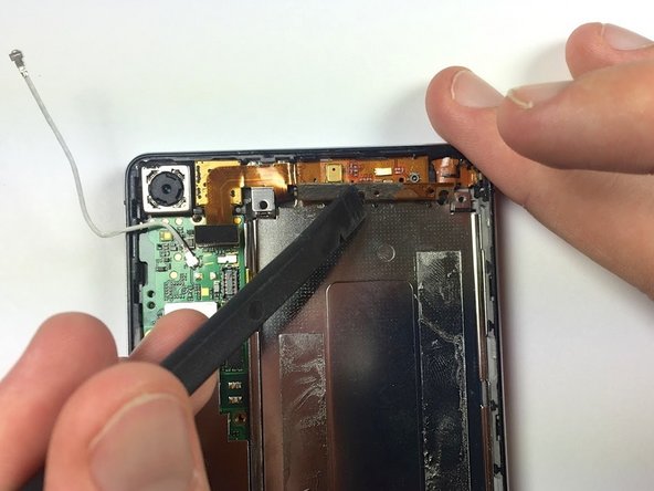

  8. Huawei Ascend P6-U06 Micro-USB Flex Cable Replacement: crwdns2935265:08crwdnd2935265:01crwdnd2935265:03crwdne2935265:0 Huawei Ascend P6-U06 Micro-USB Flex Cable Replacement: crwdns2935265:08crwdnd2935265:02crwdnd2935265:03crwdne2935265:0 Huawei Ascend P6-U06 Micro-USB Flex Cable Replacement: crwdns2935265:08crwdnd2935265:03crwdnd2935265:03crwdne2935265:0
    • Use the pointy end of a spudger to pry the antenna connector off of its socket.
    • Upon reassembly, you will hear a "click" that indicates the pin has been properly reconnected.
