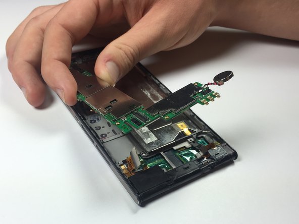

  16. Huawei Ascend P6-U06 Front/Rear Camera Replacement, Motherboard: crwdns2935265:016crwdnd2935265:01crwdnd2935265:01crwdne2935265:0
    • Use the pointy end of a spudger to wedge underneath the black circular vibrator motor near the bottom right of the phone.
    • Slowly lift up to separate the black circular vibrator motor from the adhesive.
    • The vibrator motor will remain connected to the motherboard by two red and black wires.
    • Be careful not to tear the red and black wires. If damaged, they will require soldering.
  17. Huawei Ascend P6-U06 Front/Rear Camera Replacement: crwdns2935265:017crwdnd2935265:01crwdnd2935265:02crwdne2935265:0 Huawei Ascend P6-U06 Front/Rear Camera Replacement: crwdns2935265:017crwdnd2935265:02crwdnd2935265:02crwdne2935265:0
    • Hold down the bottom left corner of the motherboard and slowly lift the right side out of the main frame.
    • Gently wiggle the logic board to release it from the phone.

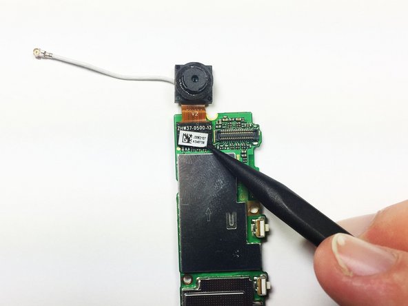

  18. Huawei Ascend P6-U06 Front/Rear Camera Replacement, Front/Rear Camera: crwdns2935265:018crwdnd2935265:01crwdnd2935265:03crwdne2935265:0 Huawei Ascend P6-U06 Front/Rear Camera Replacement, Front/Rear Camera: crwdns2935265:018crwdnd2935265:02crwdnd2935265:03crwdne2935265:0 Huawei Ascend P6-U06 Front/Rear Camera Replacement, Front/Rear Camera: crwdns2935265:018crwdnd2935265:03crwdnd2935265:03crwdne2935265:0
    • Flip over the motherboard to access the camera connector sockets.
    • Use the pointy end of a spudger to gently pop up off the rear camera from the bottom right corner.
    • Use the pointy end of a spudger to gently pop up off the front camera from the bottom right corner.
    • Be careful not to damage the electronics beneath the camera by prying too firmly with the spudger.
