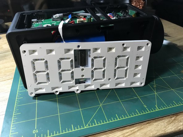

  5. Htterino Projection Alarm Clock LED projector Replacement, Disconnect front-face clock data cable: crwdns2935265:05crwdnd2935265:01crwdnd2935265:02crwdne2935265:0 Htterino Projection Alarm Clock LED projector Replacement, Disconnect front-face clock data cable: crwdns2935265:05crwdnd2935265:02crwdnd2935265:02crwdne2935265:0
    • This tiny flat cable is wedged into a connector on the circuit board. Pull it out carefully to avoid wrecking the cable, and remove the screws from the white plastic housing that holds the clock face LEDs.

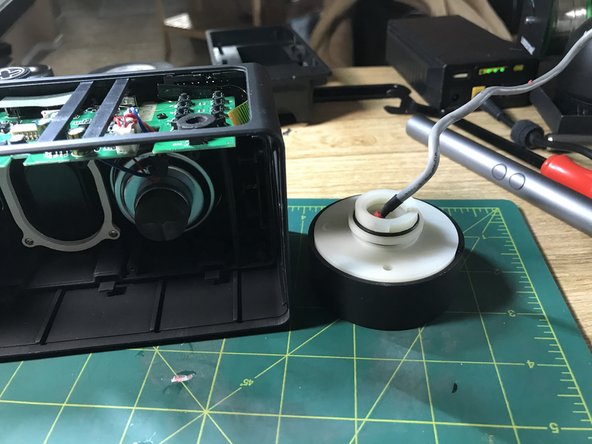

  9. Htterino Projection Alarm Clock LED projector Replacement, Detach the projector cable: crwdns2935265:09crwdnd2935265:01crwdnd2935265:01crwdne2935265:0
    • On top of the circuit board, find the cable with yellow, green, black, and gray wires. Carefully unplug the fixture that connects it to the board. You should be able to carefully push this cable out from it's position on the top of the board so it is inside the clock and connected to the projection wheel.
  10. Htterino Projection Alarm Clock LED projector Replacement, Remove the projector wheel: crwdns2935265:010crwdnd2935265:01crwdnd2935265:02crwdne2935265:0 Htterino Projection Alarm Clock LED projector Replacement, Remove the projector wheel: crwdns2935265:010crwdnd2935265:02crwdnd2935265:02crwdne2935265:0
    • Carefully ensure the projector cable isn't wedged into any area under the circuit board or around the remaining base plastic housing. Grab the projection wheel and pull it toward the front and notice how it unseats from the plastic housing of the clock.
  11. Htterino Projection Alarm Clock LED projector Replacement, Remove the screws from the wheel: crwdns2935265:011crwdnd2935265:01crwdnd2935265:01crwdne2935265:0
    • Remove the two screws holding the white plastic to the dark plastic.
  12. Htterino Projection Alarm Clock LED projector Replacement, Disassemble the Wheel: crwdns2935265:012crwdnd2935265:01crwdnd2935265:01crwdne2935265:0
    • Carefully pull the white plastic from the dark plastic and disassemble the projection wheel into five parts.
