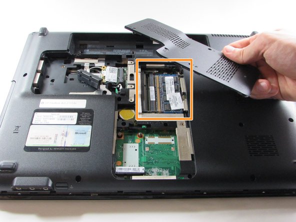

  12. Hp Pavilion dv6-2155dx Audio Jack  Replacement, Audio Jack: crwdns2935265:012crwdnd2935265:01crwdnd2935265:02crwdne2935265:0 Hp Pavilion dv6-2155dx Audio Jack  Replacement, Audio Jack: crwdns2935265:012crwdnd2935265:02crwdnd2935265:02crwdne2935265:0
    • Flip the laptop over and locate the memory module panel and loosen the 3 screws holding down the panel.
    • Remove the panel to expose the 2 memory modules.
    • When the screws are loosened, they will remain connected to the panel.

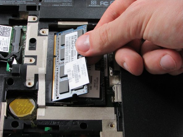

  13. Hp Pavilion dv6-2155dx Audio Jack  Replacement: crwdns2935265:013crwdnd2935265:01crwdnd2935265:02crwdne2935265:0 Hp Pavilion dv6-2155dx Audio Jack  Replacement: crwdns2935265:013crwdnd2935265:02crwdnd2935265:02crwdne2935265:0
    • Remove the memory modules by using your index finger and thumb to spread apart the silver retaining tabs on both sides of the modules. After spreading the tabs apart, lift and pull the module out at an angle.
    • Repeat this action for the second memory module that is directly under the first.

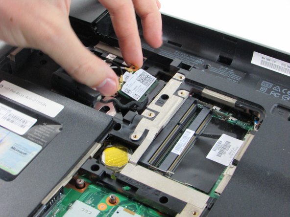

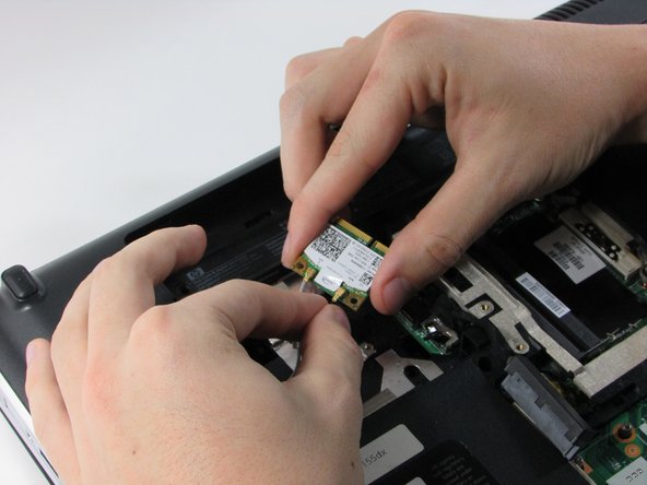

  14. Hp Pavilion dv6-2155dx Audio Jack  Replacement: crwdns2935265:014crwdnd2935265:01crwdnd2935265:03crwdne2935265:0 Hp Pavilion dv6-2155dx Audio Jack  Replacement: crwdns2935265:014crwdnd2935265:02crwdnd2935265:03crwdne2935265:0 Hp Pavilion dv6-2155dx Audio Jack  Replacement: crwdns2935265:014crwdnd2935265:03crwdnd2935265:03crwdne2935265:0
    • Locate the WLAN module located in the hard drive panel and remove the single silver screw holding the WLAN module.
    • The silver screw is 4mm long and the head is 4mm wide.
    • After screw is removed, gently disconnect the WLAN module using your thumb and index finger from the connector.
    • Disconnect the two WLAN antenna cables (white and black) attached to the WLAN module by gently lifting and holding onto the gold base.
    • The wires are numbered as "1" and "2". When reconnecting, connect the designated location notated by "J1" and "J2" on the module.

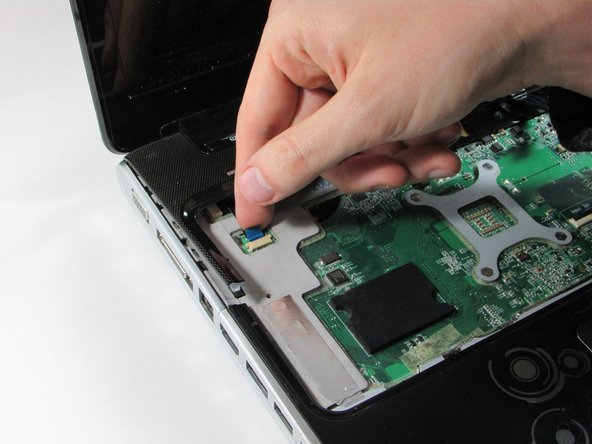

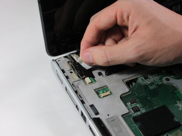

    • Disconnect the LED board and power button cables from the connector on the system board by pulling the blue Mylar tabs toward the display screen.
  17. Hp Pavilion dv6-2155dx Audio Jack  Replacement: crwdns2935265:017crwdnd2935265:01crwdnd2935265:02crwdne2935265:0 Hp Pavilion dv6-2155dx Audio Jack  Replacement: crwdns2935265:017crwdnd2935265:02crwdnd2935265:02crwdne2935265:0

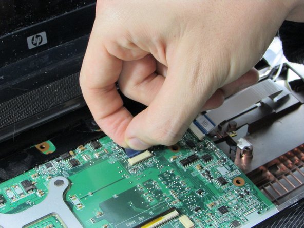

    • Disconnect the display cable by lifting the Mylar tab up towards the screen.

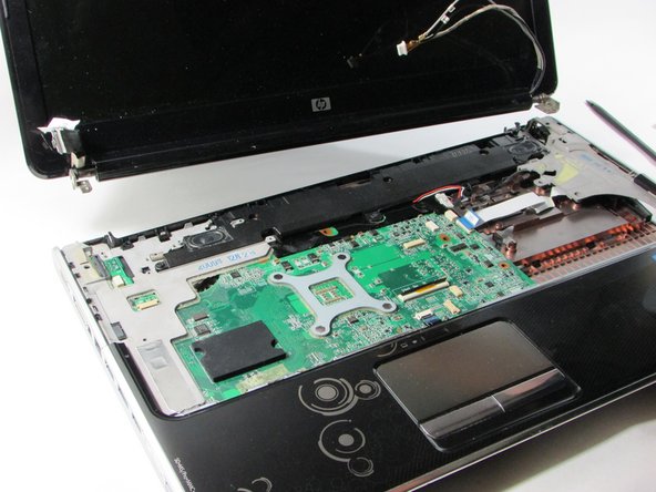

  21. Hp Pavilion dv6-2155dx Audio Jack  Replacement: crwdns2935265:021crwdnd2935265:01crwdnd2935265:03crwdne2935265:0 Hp Pavilion dv6-2155dx Audio Jack  Replacement: crwdns2935265:021crwdnd2935265:02crwdnd2935265:03crwdne2935265:0 Hp Pavilion dv6-2155dx Audio Jack  Replacement: crwdns2935265:021crwdnd2935265:03crwdnd2935265:03crwdne2935265:0
    • Remove the four screws that connect the display to the laptop, two screws per side.
    • The screws are 7mm long and the head is 4mm wide.
    • Now you can safely remove the screen from the body of the laptop.

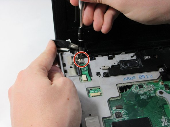

  22. Hp Pavilion dv6-2155dx Audio Jack  Replacement: crwdns2935265:022crwdnd2935265:01crwdnd2935265:01crwdne2935265:0
    • After removal of the display, you will see and need to remove four black screws
    • The three red marked screws: 4 mm long, heads are 4 mm wide. Orange marked screws: 4mm long and the head is 5mm wide.

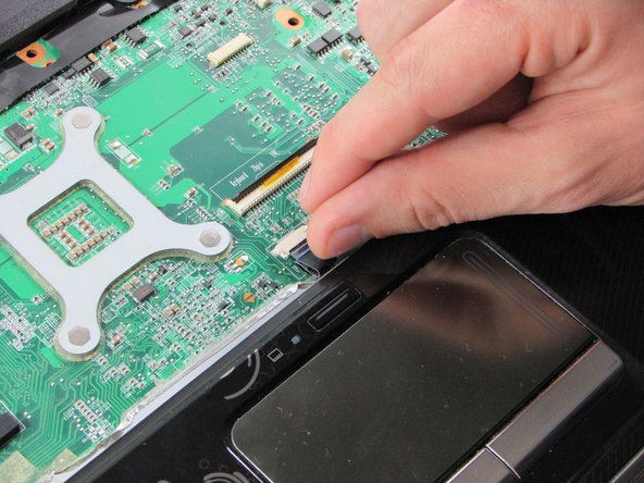

    • Disconnect the touch pad ribbon cable from the system board by gripping and pulling the blue tab toward you.

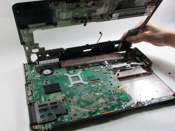

  24. Hp Pavilion dv6-2155dx Audio Jack  Replacement: crwdns2935265:024crwdnd2935265:01crwdnd2935265:02crwdne2935265:0 Hp Pavilion dv6-2155dx Audio Jack  Replacement: crwdns2935265:024crwdnd2935265:02crwdnd2935265:02crwdne2935265:0
    • Starting in the front of the laptop, use a flat plastic spudger to gently pry the silver/chrome plastic bar off of the front of the laptop.
    • Once the silver/chrome bar is removed, the laptop cover should be loosened enough to remove.
    • You may need to pry along the sides of the laptop with the spudger if the laptop cover isn't loosened completely.

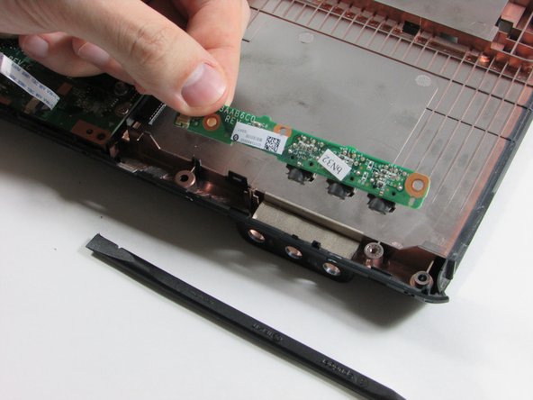

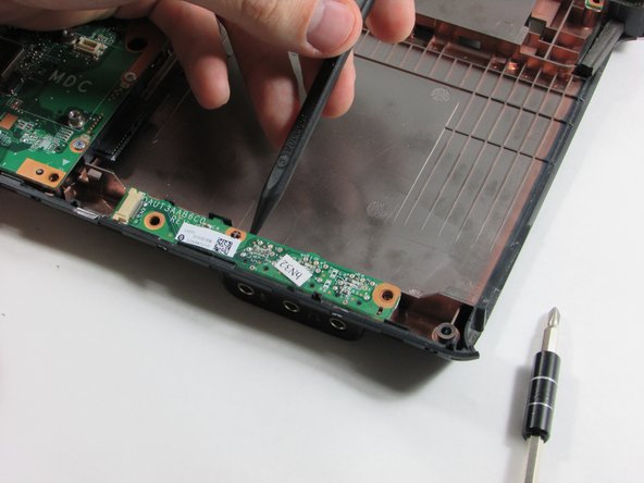

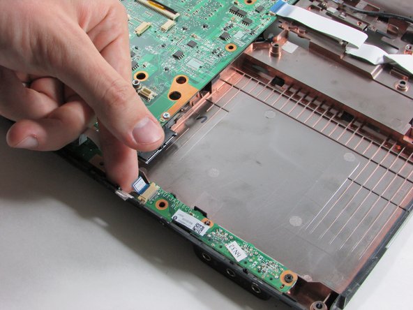

  26. Hp Pavilion dv6-2155dx Audio Jack  Replacement: crwdns2935265:026crwdnd2935265:01crwdnd2935265:03crwdne2935265:0 Hp Pavilion dv6-2155dx Audio Jack  Replacement: crwdns2935265:026crwdnd2935265:02crwdnd2935265:03crwdne2935265:0 Hp Pavilion dv6-2155dx Audio Jack  Replacement: crwdns2935265:026crwdnd2935265:03crwdnd2935265:03crwdne2935265:0
    • Remove the 2 black screws on the bottom right hand corner of the system board.
    • Screws are black, 7 mm long and head width 4 mm.
    • The headphone/microphone jack will now be lose and you can remove it from the system board.
