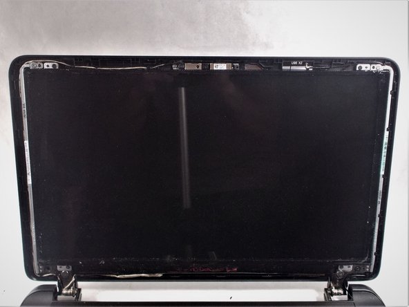

  5. Hp 15-f305dx Screen Replacement, Screen: crwdns2935265:05crwdnd2935265:01crwdnd2935265:03crwdne2935265:0 Hp 15-f305dx Screen Replacement, Screen: crwdns2935265:05crwdnd2935265:02crwdnd2935265:03crwdne2935265:0 Hp 15-f305dx Screen Replacement, Screen: crwdns2935265:05crwdnd2935265:03crwdnd2935265:03crwdne2935265:0

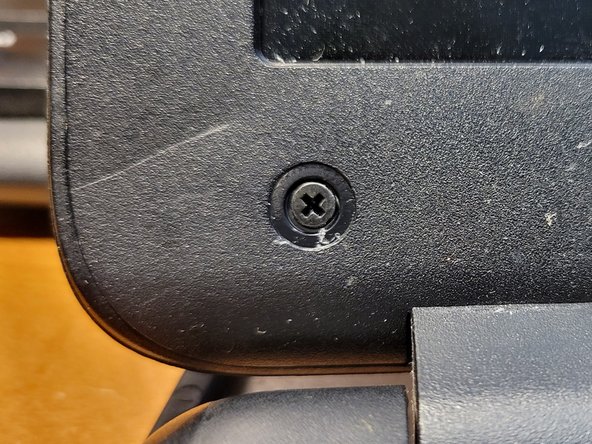

    • Remove the bezel by prying it away from the screen using the spudger.
    • Note: Some models may have two screws hidden behind round covers in the lower section of the bezel.
  6. Hp 15-f305dx Screen Replacement: crwdns2935265:06crwdnd2935265:01crwdnd2935265:01crwdne2935265:0
    • Remove the four 3mm PH1 Phillips head screws in each corner of the screen and do not care about outer screws.

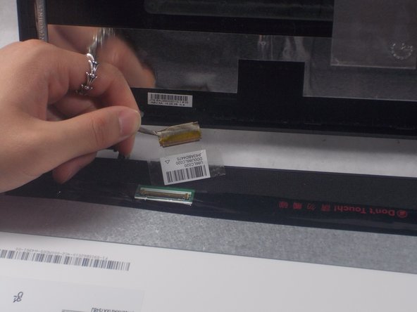

  8. Hp 15-f305dx Screen Replacement: crwdns2935265:08crwdnd2935265:01crwdnd2935265:02crwdne2935265:0 Hp 15-f305dx Screen Replacement: crwdns2935265:08crwdnd2935265:02crwdnd2935265:02crwdne2935265:0
    • Remove the sticker gently and disconnect the metal blade.
