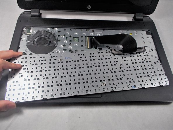

  7. Hp 15-f305dx Hard Drive Replacement: crwdns2935265:07crwdnd2935265:01crwdnd2935265:02crwdne2935265:0 Hp 15-f305dx Hard Drive Replacement: crwdns2935265:07crwdnd2935265:02crwdnd2935265:02crwdne2935265:0
    • Pry the keyboard out of the laptop gently and flip the keyboard around.
  8. Hp 15-f305dx Hard Drive Replacement: crwdns2935265:08crwdnd2935265:01crwdnd2935265:01crwdne2935265:0
    • Disconnect the connected cable from the mainboard.

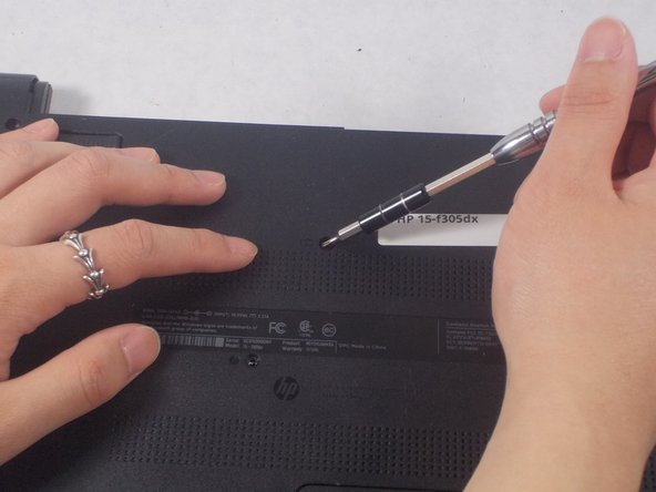

  9. Hp 15-f305dx Hard Drive Replacement, Hard Drive: crwdns2935265:09crwdnd2935265:01crwdnd2935265:02crwdne2935265:0 Hp 15-f305dx Hard Drive Replacement, Hard Drive: crwdns2935265:09crwdnd2935265:02crwdnd2935265:02crwdne2935265:0
    • Remove the twelve screws from the bottom of the laptop with the Philips #0 Screwdriver.

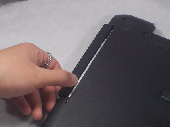

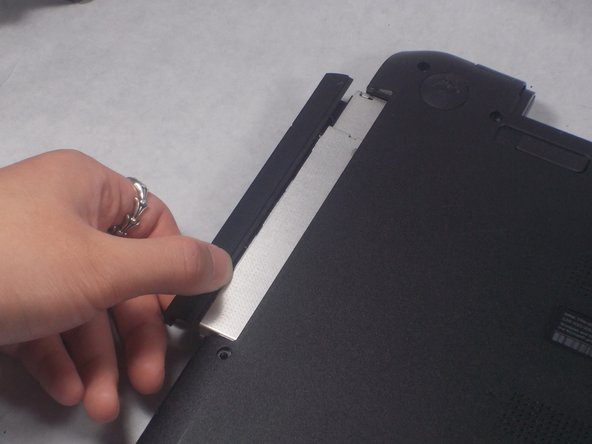

  10. Hp 15-f305dx Hard Drive Replacement: crwdns2935265:010crwdnd2935265:01crwdnd2935265:03crwdne2935265:0 Hp 15-f305dx Hard Drive Replacement: crwdns2935265:010crwdnd2935265:02crwdnd2935265:03crwdne2935265:0 Hp 15-f305dx Hard Drive Replacement: crwdns2935265:010crwdnd2935265:03crwdnd2935265:03crwdne2935265:0
    • Eject the CD player on the side of the laptop by sliding it out.

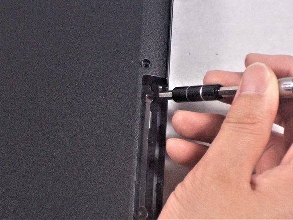

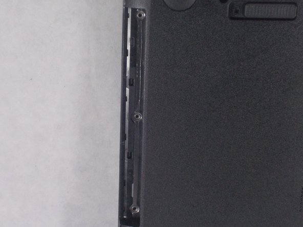

  11. Hp 15-f305dx Hard Drive Replacement: crwdns2935265:011crwdnd2935265:01crwdnd2935265:03crwdne2935265:0 Hp 15-f305dx Hard Drive Replacement: crwdns2935265:011crwdnd2935265:02crwdnd2935265:03crwdne2935265:0 Hp 15-f305dx Hard Drive Replacement: crwdns2935265:011crwdnd2935265:03crwdnd2935265:03crwdne2935265:0
    • Use a Phillips # 1 Screwdriver to unscrew the three screws under the CD player

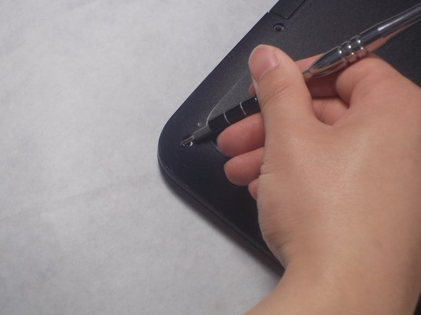

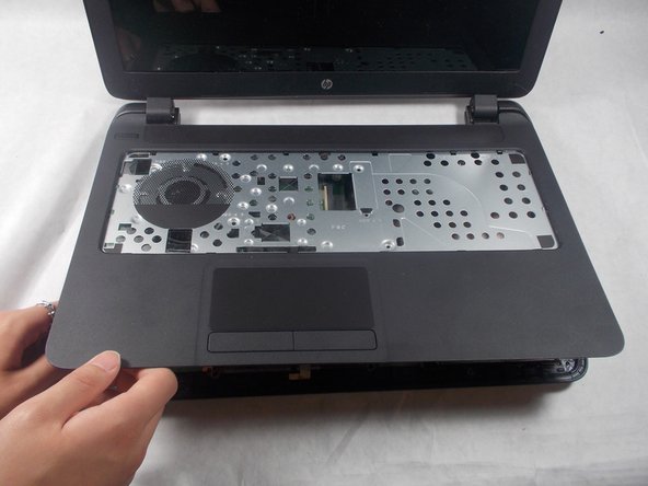

  12. Hp 15-f305dx Hard Drive Replacement: crwdns2935265:012crwdnd2935265:01crwdnd2935265:03crwdne2935265:0 Hp 15-f305dx Hard Drive Replacement: crwdns2935265:012crwdnd2935265:02crwdnd2935265:03crwdne2935265:0 Hp 15-f305dx Hard Drive Replacement: crwdns2935265:012crwdnd2935265:03crwdnd2935265:03crwdne2935265:0
    • Flip the device around and open it. Use the blue spudger tool to remove the casing around the keyboard space by driving it the crease and propping it up.
    • Once you have used the spudger tool all the way around the casing, lift the casing up from the device.

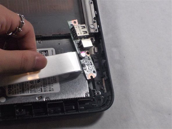

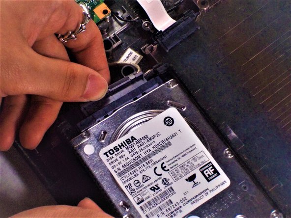

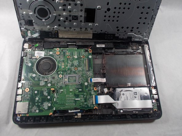

  13. Hp 15-f305dx Hard Drive Replacement: crwdns2935265:013crwdnd2935265:01crwdnd2935265:02crwdne2935265:0 Hp 15-f305dx Hard Drive Replacement: crwdns2935265:013crwdnd2935265:02crwdnd2935265:02crwdne2935265:0
    • Use a Phillips #0 screwdriver to remove the screw that holds the USB drive in the bottom right corner near the hard drive. Once removed, lift the USB drive off of the hard drive.

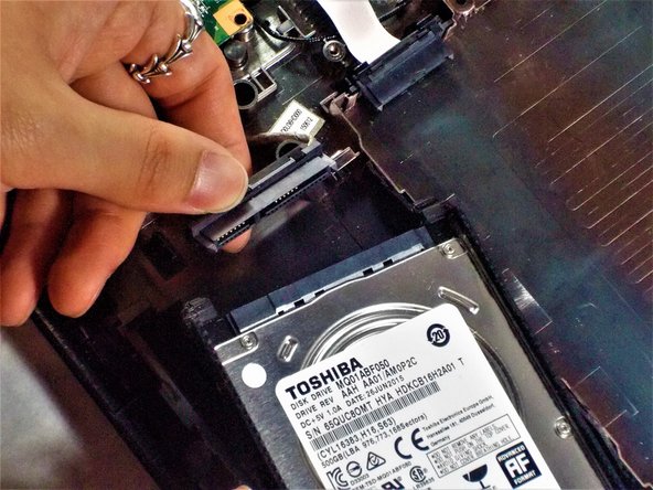

  14. Hp 15-f305dx Hard Drive Replacement: crwdns2935265:014crwdnd2935265:01crwdnd2935265:03crwdne2935265:0 Hp 15-f305dx Hard Drive Replacement: crwdns2935265:014crwdnd2935265:02crwdnd2935265:03crwdne2935265:0 Hp 15-f305dx Hard Drive Replacement: crwdns2935265:014crwdnd2935265:03crwdnd2935265:03crwdne2935265:0
    • Lift the hard drive from the device and unconnect the cord attached to it.
