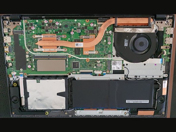

  1. How toInstall a PCIe PCIe NVMe Gen3 module, Open the back Cover: crwdns2935265:01crwdnd2935265:01crwdnd2935265:03crwdne2935265:0 How toInstall a PCIe PCIe NVMe Gen3 module, Open the back Cover: crwdns2935265:01crwdnd2935265:02crwdnd2935265:03crwdne2935265:0 How toInstall a PCIe PCIe NVMe Gen3 module, Open the back Cover: crwdns2935265:01crwdnd2935265:03crwdnd2935265:03crwdne2935265:0
    • Remove all screws shown in the image

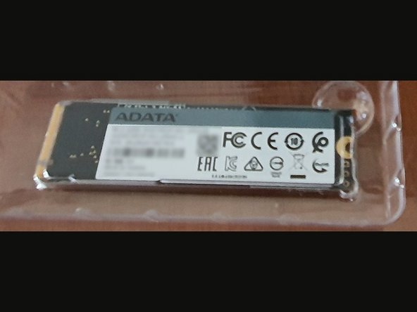

  2. How toInstall a PCIe PCIe NVMe Gen3 module, Save the screws: crwdns2935265:02crwdnd2935265:01crwdnd2935265:01crwdne2935265:0
    • The bottom screws are different. Save them
    • Find a new screw to fix the module

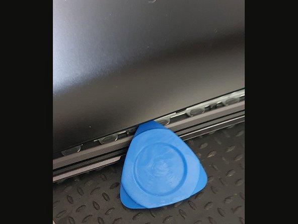

  3. How toInstall a PCIe PCIe NVMe Gen3 module, Remove back cover: crwdns2935265:03crwdnd2935265:01crwdnd2935265:03crwdne2935265:0 How toInstall a PCIe PCIe NVMe Gen3 module, Remove back cover: crwdns2935265:03crwdnd2935265:02crwdnd2935265:03crwdne2935265:0 How toInstall a PCIe PCIe NVMe Gen3 module, Remove back cover: crwdns2935265:03crwdnd2935265:03crwdnd2935265:03crwdne2935265:0
    • Open the back cover carefully using a plastic tool that will not damage the cover. .
    • Start at the bottom
    • Continue along the lid

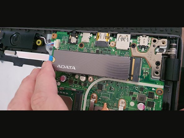

  4. How toInstall a PCIe PCIe NVMe Gen3 module, Install the PCIe NVMe Module: crwdns2935265:04crwdnd2935265:01crwdnd2935265:03crwdne2935265:0 How toInstall a PCIe PCIe NVMe Gen3 module, Install the PCIe NVMe Module: crwdns2935265:04crwdnd2935265:02crwdnd2935265:03crwdne2935265:0 How toInstall a PCIe PCIe NVMe Gen3 module, Install the PCIe NVMe Module: crwdns2935265:04crwdnd2935265:03crwdnd2935265:03crwdne2935265:0
    • Install the new module in the corresponding slot
  5. How toInstall a PCIe PCIe NVMe Gen3 module, Fix the  PCIe PCIe NVMe Module: crwdns2935265:05crwdnd2935265:01crwdnd2935265:01crwdne2935265:0
    • Use a suitable screw and screw in place
    • Done
