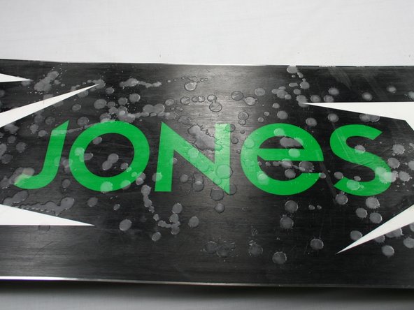

  5. How to wax your snowboard, How to wax your snowboard: crwdns2935265:05crwdnd2935265:01crwdnd2935265:01crwdne2935265:0
    • Turn the snowboard over so the bottom of the board is facing up.
    • Set the snowboard down on a stable work surface so that it does not rock or move.
    • We recommend using a table that is small enough to fit between the curves on either side of the board, or placing blocks of wood to raise the board from the table.

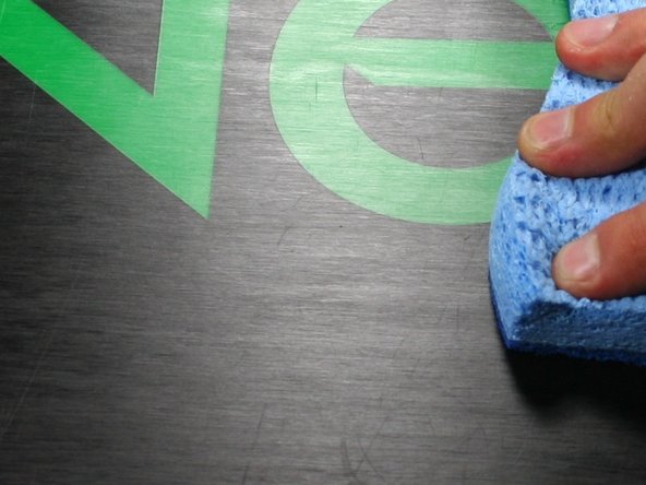

  6. How to wax your snowboard: crwdns2935265:06crwdnd2935265:01crwdnd2935265:01crwdne2935265:0
    • If the bottom of your board has dirt or oil on it, clean it off using a shop towel and a citrus based cleaner.
    • Only a couple drops of cleaner are needed.
    • Allow the base of your board to completely dry before you continue. Any oil or dirt left on your board will prevent the wax from sticking to the board.

  8. How to wax your snowboard: crwdns2935265:08crwdnd2935265:01crwdnd2935265:02crwdne2935265:0 How to wax your snowboard: crwdns2935265:08crwdnd2935265:02crwdnd2935265:02crwdne2935265:0
    • Hold the iron perpendicular to the snowboard and rub the wax directly onto the iron.
    • Let the wax drip off the iron and onto the snowboard. Cover the entire board evenly with drips.
    • Only a thin layer of wax is needed. The more wax you put on, the more you will have to scrape off later. Keep this information in mind when deciding how much wax to melt onto the board. It is better to put on too little and add some on than to have too much and have to scrape it off.
  9. How to wax your snowboard: crwdns2935265:09crwdnd2935265:01crwdnd2935265:03crwdne2935265:0 How to wax your snowboard: crwdns2935265:09crwdnd2935265:02crwdnd2935265:03crwdne2935265:0 How to wax your snowboard: crwdns2935265:09crwdnd2935265:03crwdnd2935265:03crwdne2935265:0
    • Place the iron directly onto the board and smooth down the wax drips.
    • Continue using circular motions until the wax is evenly distributed across the board.
    • Do not leave the iron sitting in one place for too long, or it may melt the snowboard.
    • Let the wax cool down for a minimum of 30 minutes.
    • The longer the wax has to cool down, the better the final product will be.
