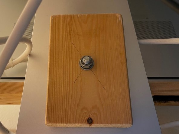

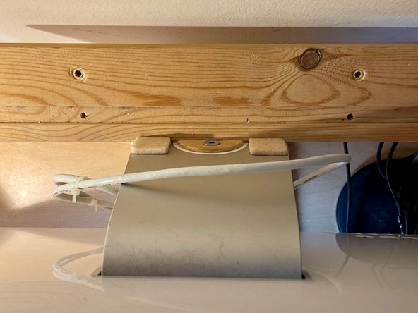

    • To keep everything neat, and as I had a separate keyboard and Magic Mouse, I also wanted to rear mount the Macbook - I created a mount from wood in a similar style to the AluRack, mounting onto the cable hole on the iMac stand - perfect!
  7. How to turn an iMac Intel into an External Monitor, More info on the mount: crwdns2935265:07crwdnd2935265:01crwdnd2935265:03crwdne2935265:0 How to turn an iMac Intel into an External Monitor, More info on the mount: crwdns2935265:07crwdnd2935265:02crwdnd2935265:03crwdne2935265:0 How to turn an iMac Intel into an External Monitor, More info on the mount: crwdns2935265:07crwdnd2935265:03crwdnd2935265:03crwdne2935265:0
    • I have added a few further images of the MacBook mount I made - hopefully they are decipherable / useful!
