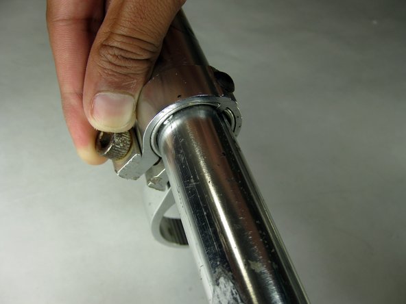

    • Locate the T-tube clamp. It is in the middle of the steering column.
  2. How to tighten the Razor A handlebar clamp: crwdns2935265:02crwdnd2935265:01crwdnd2935265:02crwdne2935265:0 How to tighten the Razor A handlebar clamp: crwdns2935265:02crwdnd2935265:02crwdnd2935265:02crwdne2935265:0
    • Open the clamp by pulling the lever away from the scooter.
  3. How to tighten the Razor A handlebar clamp: crwdns2935265:03crwdnd2935265:01crwdnd2935265:02crwdne2935265:0 How to tighten the Razor A handlebar clamp: crwdns2935265:03crwdnd2935265:02crwdnd2935265:02crwdne2935265:0
    • Locate the screw on the side of clamp.
    • Turn the screw on the side of the clamp by hand in a clockwise direction.
    • Attempt to close the clamp. If the lever is too tight to close, loosen the screw slightly and try again.
    • The T-tube should now be locked in place. If it continues to fall down, repeat the instructions in this guide.
