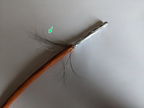

  3. How to strip Cat.7 S/FTP PiMF Ethernet Cable, Pull back the braided shield: crwdns2935265:03crwdnd2935265:01crwdnd2935265:03crwdne2935265:0 How to strip Cat.7 S/FTP PiMF Ethernet Cable, Pull back the braided shield: crwdns2935265:03crwdnd2935265:02crwdnd2935265:03crwdne2935265:0 How to strip Cat.7 S/FTP PiMF Ethernet Cable, Pull back the braided shield: crwdns2935265:03crwdnd2935265:03crwdnd2935265:03crwdne2935265:0
    • Pull back the grounding mesh and twist it around the first cm of still insulated cable.
    • You can leave the excess, but if you want to cut it, make sure to leave at least about 1cm.

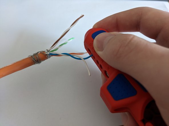

  4. How to strip Cat.7 S/FTP PiMF Ethernet Cable, Spread the twisted pairs: crwdns2935265:04crwdnd2935265:01crwdnd2935265:01crwdne2935265:0
    • Spread out the twisted pairs to make them easier to work with.

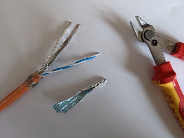

  5. How to strip Cat.7 S/FTP PiMF Ethernet Cable, Remove the shielding: crwdns2935265:05crwdnd2935265:01crwdnd2935265:02crwdne2935265:0 How to strip Cat.7 S/FTP PiMF Ethernet Cable, Remove the shielding: crwdns2935265:05crwdnd2935265:02crwdnd2935265:02crwdne2935265:0
    Flush Cutter
    $29.99
    • Unwrap the shielding a bit and nick it at the base with some electronics side cutters.
    • If you will wire this cable in a terminal block instead of a Keystone or crimping on a connector, you should just remove the minimum amount of shielding needed to properly punch down the connection.
    • Make sure to not damage the delicate insulation of the individual wires.
    • Rip off the shielding.
    • Repeat for all four twisted pairs.

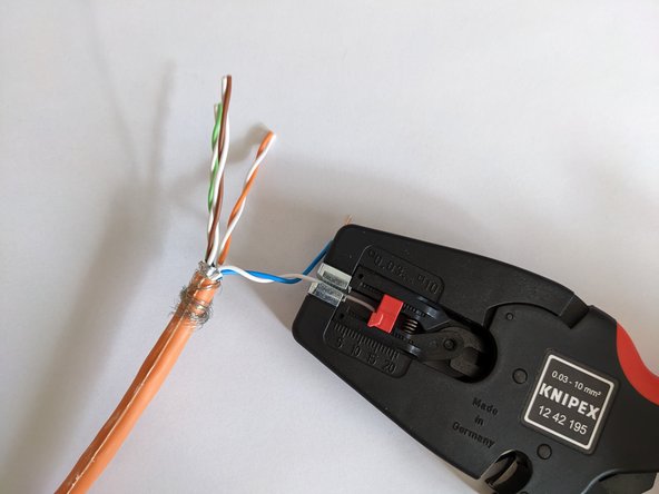

  6. How to strip Cat.7 S/FTP PiMF Ethernet Cable, Strip the wire (optional): crwdns2935265:06crwdnd2935265:01crwdnd2935265:03crwdne2935265:0 How to strip Cat.7 S/FTP PiMF Ethernet Cable, Strip the wire (optional): crwdns2935265:06crwdnd2935265:02crwdnd2935265:03crwdne2935265:0 How to strip Cat.7 S/FTP PiMF Ethernet Cable, Strip the wire (optional): crwdns2935265:06crwdnd2935265:03crwdnd2935265:03crwdne2935265:0
    • Stripping the wire itself is optional, depending on what you want to do with it. P. ex. if you are going to punch it down into an LSA Plus block, you don't need to strip the wire.
    • Grip the wire with the 0.3 mm notch and pull off the insulation or use automatic wire strippers.
    • Stripping off 1cm is usually enough.
