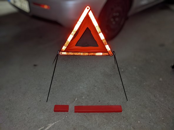

  3. How to set up a warning triangle, Unpack and unfold the warning triangle: crwdns2935265:03crwdnd2935265:01crwdnd2935265:02crwdne2935265:0 How to set up a warning triangle, Unpack and unfold the warning triangle: crwdns2935265:03crwdnd2935265:02crwdnd2935265:02crwdne2935265:0
    • Outside the dangerous area, ideally beyond the crash barrier, unpack and fully unfold the warning triangle.
    • Depending on the design, twist the two lower bars in the middle until they form a cross, or fold out the four feet - 2 each at the bottom corners of the triangle - forwards and backwards until the warning triangle can be set up stably.
    • Above the base are the three red bars. Two of them can be pulled up and locked together to form the legs of the triangle. The plastic inner film folds open automatically.
    • In order not to forget the warning triangle when driving off, you should put the packaging on the driver's seat - so you remember it immediately when you get in.
  4. How to set up a warning triangle, Setting up the warning triangle: crwdns2935265:04crwdnd2935265:01crwdnd2935265:01crwdne2935265:0
    • Walk towards traffic while keeping the warning triangle visible in front of you, ideally at chest height.
    • Only walk at the very edge of the lane, ideally behind the crash barrier.
    • Now set it up on the roadside - the distance to the vehicle should be around 50 meters in urban areas, 100 meters on country roads and at least 150 meters on the motorway.
