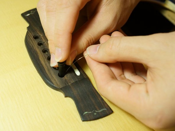

  3. How to restring an Acoustic Guitar: crwdns2935265:03crwdnd2935265:01crwdnd2935265:03crwdne2935265:0 How to restring an Acoustic Guitar: crwdns2935265:03crwdnd2935265:02crwdnd2935265:03crwdne2935265:0 How to restring an Acoustic Guitar: crwdns2935265:03crwdnd2935265:03crwdnd2935265:03crwdne2935265:0
    • Take the new strings out of of the package.
    • Pin the stings onto the bridge, into the pinholes from left to right in the following order; E(low)-A-D-G-B-E(high).
    • Refer to the cover of guitar strings package to distinguish the strings.

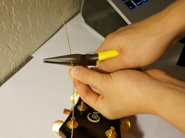

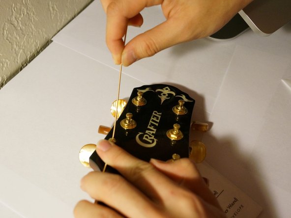

  4. How to restring an Acoustic Guitar: crwdns2935265:04crwdnd2935265:01crwdnd2935265:03crwdne2935265:0 How to restring an Acoustic Guitar: crwdns2935265:04crwdnd2935265:02crwdnd2935265:03crwdne2935265:0 How to restring an Acoustic Guitar: crwdns2935265:04crwdnd2935265:03crwdnd2935265:03crwdne2935265:0
    • Insert the end of each string into the head machine.
    • Leave about 1 to 2 inches of string from the head machine and cut it using a clipper.
    • Repeat the process for all six strings.

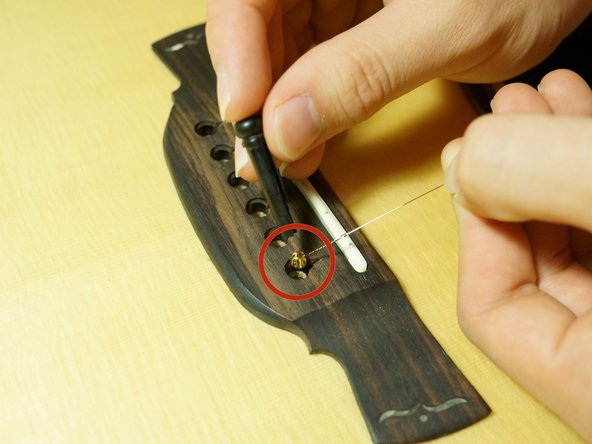

  5. How to restring an Acoustic Guitar: crwdns2935265:05crwdnd2935265:01crwdnd2935265:01crwdne2935265:0
    • Guide the string through the pin hole, so that about 1/3 of an inch of excess string comes out from behind the pin.
    • Turn the knobs in a counterclockwise direction for E(low), A, D strings.
    • Turn the knobs in a clockwise direction for G, B, E(high) strings.
