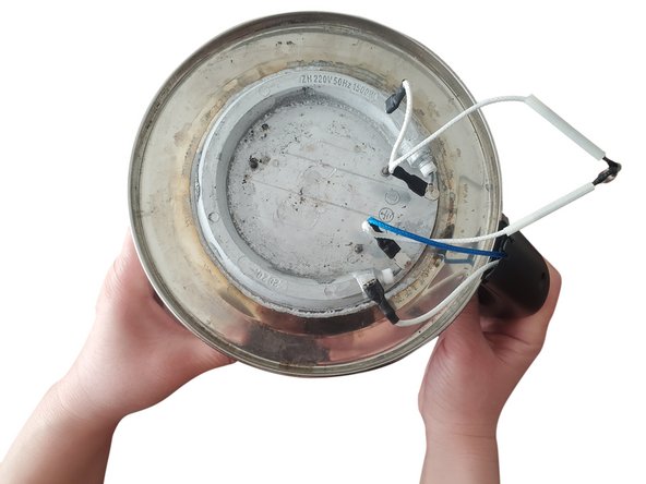

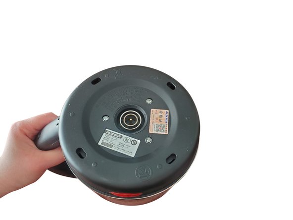

    • Clean all the dirt on the bottom of the electric kettle.

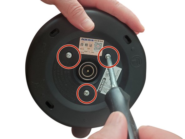

    • Use a Phillips screwdriver to unscrew the 3/4 in. Phillips Truss-Head Self-Drilling Screws at the bottom of the electric kettle counterclockwise.
    • Remove the base of the electric kettle.

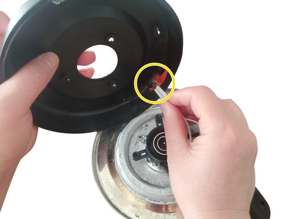

    • Remove the LED indicator buckled on the base.

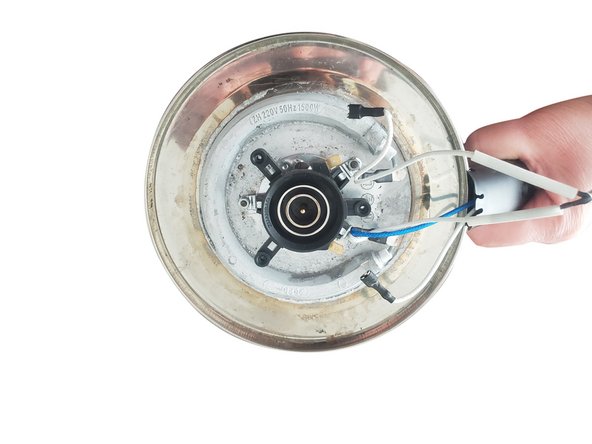

    • Use long-nose pliers to clamp the connection between the electric kettle line and the old temperature controller to create a gap, and pull it off.
    • Don't use too much force to avoid damage to the line!
