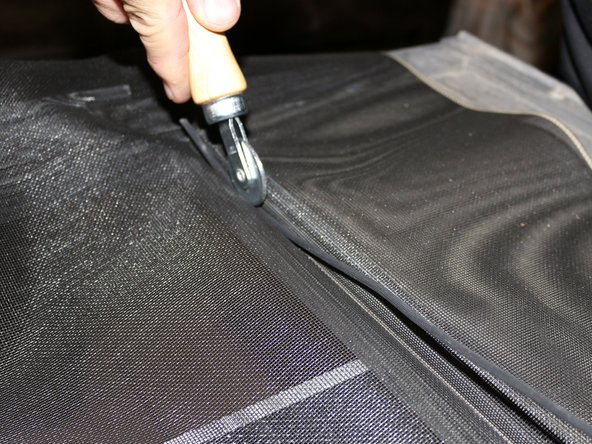

  9. How to replace the screen on a patio door.: crwdns2935265:09crwdnd2935265:01crwdnd2935265:02crwdne2935265:0 How to replace the screen on a patio door.: crwdns2935265:09crwdnd2935265:02crwdnd2935265:02crwdne2935265:0
    • Begin at a top corner and press the spline down over the screen fabric and into the groove on the frame using the convex roller.

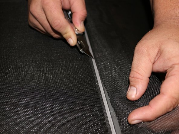

  10. How to replace the screen on a patio door.: crwdns2935265:010crwdnd2935265:01crwdnd2935265:01crwdne2935265:0
    • Trim off the excess spline using a razor blade.
    • Make sure you are careful and do not puncture the screen.
  11. How to replace the screen on a patio door.: crwdns2935265:011crwdnd2935265:01crwdnd2935265:02crwdne2935265:0 How to replace the screen on a patio door.: crwdns2935265:011crwdnd2935265:02crwdnd2935265:02crwdne2935265:0
    • Trim the extra screen material flush at the edge of the retaining spline with a razor blade, creating a neat appearance.
    • Take extra care that you do not cut the screen on the inside of the spline.
