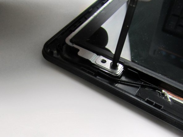

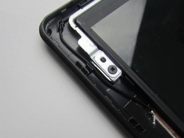

  3. How to replace the screen of a Lenovo Ideapad 300-15IBR: crwdns2935265:03crwdnd2935265:01crwdnd2935265:03crwdne2935265:0 How to replace the screen of a Lenovo Ideapad 300-15IBR: crwdns2935265:03crwdnd2935265:02crwdnd2935265:03crwdne2935265:0 How to replace the screen of a Lenovo Ideapad 300-15IBR: crwdns2935265:03crwdnd2935265:03crwdnd2935265:03crwdne2935265:0
    • Using the Phillips screwdriver, remove four 0.8 mm Phillips screws at each mounting point of the screen.
    • If you have a magnetic bowl, utilize it to keep track of the screws.

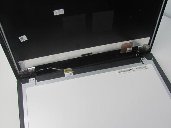

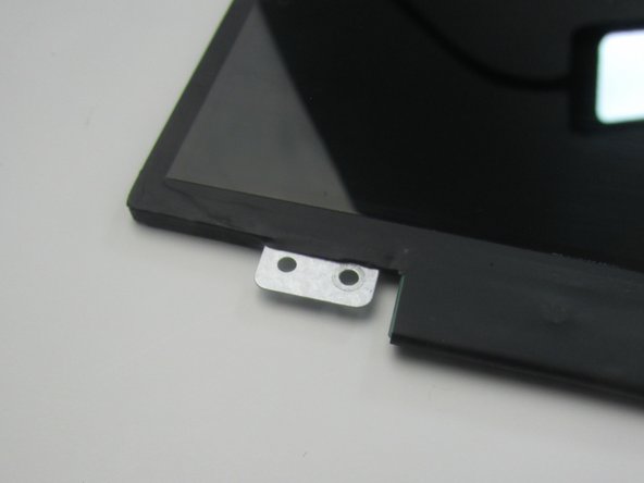

  4. How to replace the screen of a Lenovo Ideapad 300-15IBR: crwdns2935265:04crwdnd2935265:01crwdnd2935265:02crwdne2935265:0 How to replace the screen of a Lenovo Ideapad 300-15IBR: crwdns2935265:04crwdnd2935265:02crwdnd2935265:02crwdne2935265:0
    • Carefully separate screen from case, ensuring ribbon strip at the bottom doesn't become disconnected.

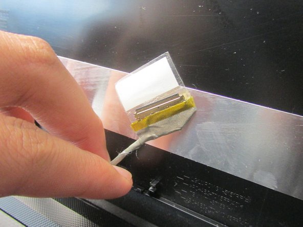

  5. How to replace the screen of a Lenovo Ideapad 300-15IBR: crwdns2935265:05crwdnd2935265:01crwdnd2935265:03crwdne2935265:0 How to replace the screen of a Lenovo Ideapad 300-15IBR: crwdns2935265:05crwdnd2935265:02crwdnd2935265:03crwdne2935265:0 How to replace the screen of a Lenovo Ideapad 300-15IBR: crwdns2935265:05crwdnd2935265:03crwdnd2935265:03crwdne2935265:0
    • Gently separate the ribbon strip connector from the back of the screen.
    • If possible, carefully peel the sticker off laptop housing without separating it from the connector.
    • Take caution to ensure the ribbon strip is disconnected with even pressure and the sticker above it has no contact with case.

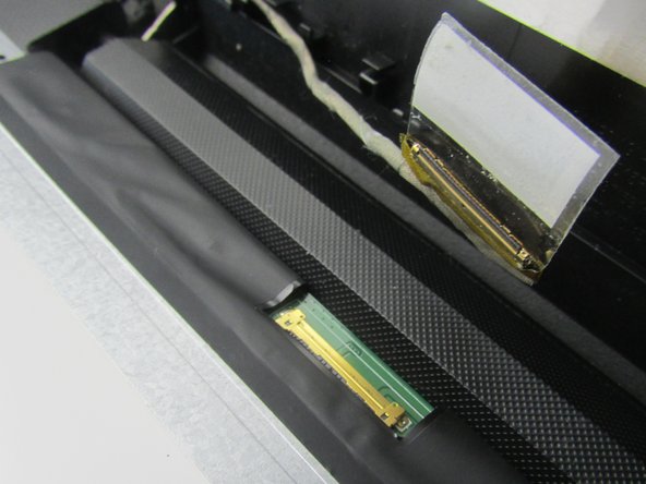

  6. How to replace the screen of a Lenovo Ideapad 300-15IBR: crwdns2935265:06crwdnd2935265:01crwdnd2935265:03crwdne2935265:0 How to replace the screen of a Lenovo Ideapad 300-15IBR: crwdns2935265:06crwdnd2935265:02crwdnd2935265:03crwdne2935265:0 How to replace the screen of a Lenovo Ideapad 300-15IBR: crwdns2935265:06crwdnd2935265:03crwdnd2935265:03crwdne2935265:0
    • Replace screen with new LCD screen and gently reconnect the ribbon strip.
    • Ensure that the ribbon strip maintains contact with the channel it is laid in.
To reassemble your device, follow these instructions in reverse order. Be sure to test whether the screen works before putting the plastic bezel back just in case.
