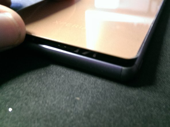

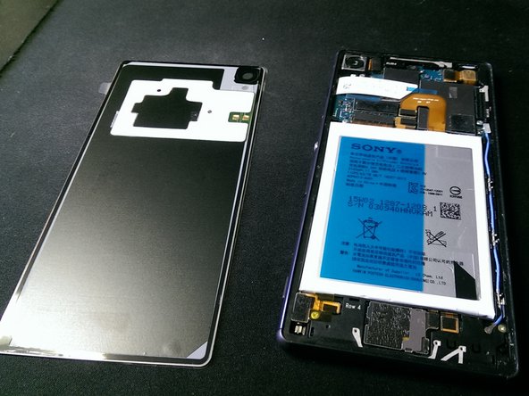

  1. How to replace a broken back cover on a Sony Xperia Z3, The Phone.: crwdns2935265:01crwdnd2935265:01crwdnd2935265:01crwdne2935265:0
    • The cover we are going to replace.

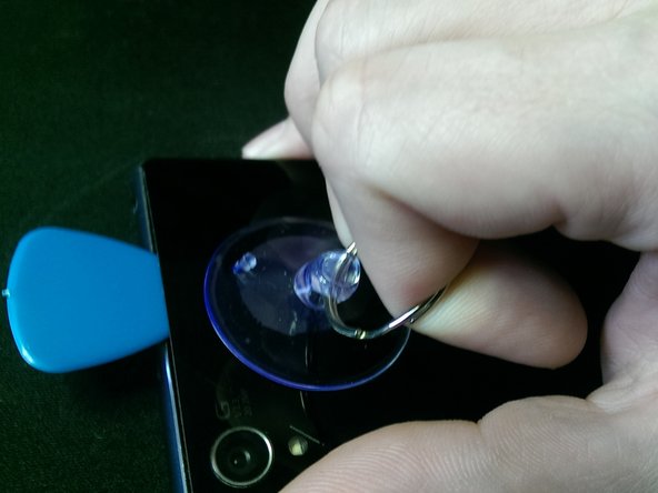

  3. How to replace a broken back cover on a Sony Xperia Z3, Loosening the cover.: crwdns2935265:03crwdnd2935265:01crwdnd2935265:03crwdne2935265:0 How to replace a broken back cover on a Sony Xperia Z3, Loosening the cover.: crwdns2935265:03crwdnd2935265:02crwdnd2935265:03crwdne2935265:0 How to replace a broken back cover on a Sony Xperia Z3, Loosening the cover.: crwdns2935265:03crwdnd2935265:03crwdnd2935265:03crwdne2935265:0
    • Use a suction-cup to pull up the back-cover about 1mm. Insert a pick and use a second one to make the opening larger.

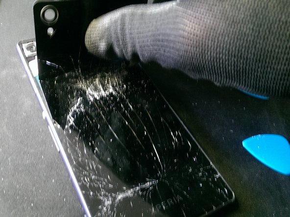

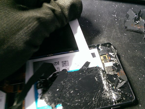

  4. How to replace a broken back cover on a Sony Xperia Z3, Removing the cover.: crwdns2935265:04crwdnd2935265:01crwdnd2935265:03crwdne2935265:0 How to replace a broken back cover on a Sony Xperia Z3, Removing the cover.: crwdns2935265:04crwdnd2935265:02crwdnd2935265:03crwdne2935265:0 How to replace a broken back cover on a Sony Xperia Z3, Removing the cover.: crwdns2935265:04crwdnd2935265:03crwdnd2935265:03crwdne2935265:0
    • Use the picks to get the cover off as far as possible. After this, wear gloves and try to pull off the glass. It will break in this step, so be careful for any pieces of sharp glass!

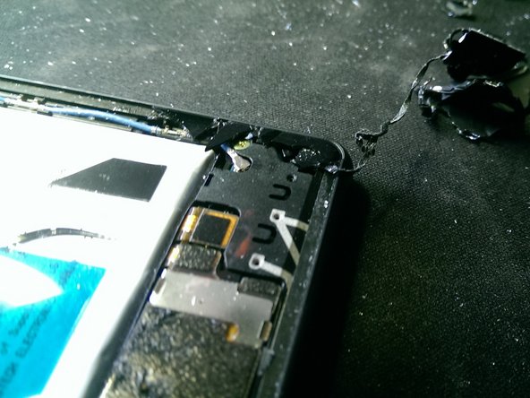

  5. How to replace a broken back cover on a Sony Xperia Z3, Removing glass.: crwdns2935265:05crwdnd2935265:01crwdnd2935265:02crwdne2935265:0 How to replace a broken back cover on a Sony Xperia Z3, Removing glass.: crwdns2935265:05crwdnd2935265:02crwdnd2935265:02crwdne2935265:0
    • Continue removing the looser pieces. Use plastic tools, so you don't damage the electronics inside.

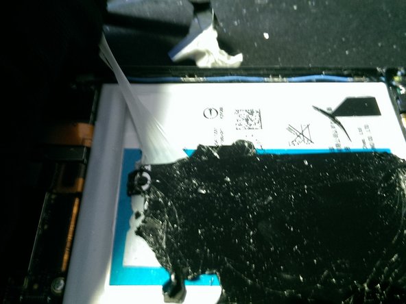

  6. How to replace a broken back cover on a Sony Xperia Z3, Removing the main piece: crwdns2935265:06crwdnd2935265:01crwdnd2935265:03crwdne2935265:0 How to replace a broken back cover on a Sony Xperia Z3, Removing the main piece: crwdns2935265:06crwdnd2935265:02crwdnd2935265:03crwdne2935265:0 How to replace a broken back cover on a Sony Xperia Z3, Removing the main piece: crwdns2935265:06crwdnd2935265:03crwdnd2935265:03crwdne2935265:0
    • Use the black tabs to pull the white double-sided tape. Remember not to pull these up, but stretch them to the sides. Pull carefully to avoid snapping.

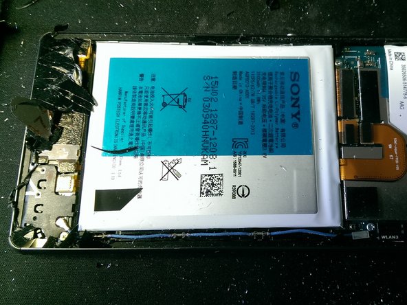

  7. How to replace a broken back cover on a Sony Xperia Z3, More glass.: crwdns2935265:07crwdnd2935265:01crwdnd2935265:03crwdne2935265:0 How to replace a broken back cover on a Sony Xperia Z3, More glass.: crwdns2935265:07crwdnd2935265:02crwdnd2935265:03crwdne2935265:0 How to replace a broken back cover on a Sony Xperia Z3, More glass.: crwdns2935265:07crwdnd2935265:03crwdnd2935265:03crwdne2935265:0
    • You can now take off the glass that was attached to the battery.
    • Carefully remove all the glass and tape that's left.
    • Clean out all the glass with a small soft brush. I used the tip of an soft toothbrush.

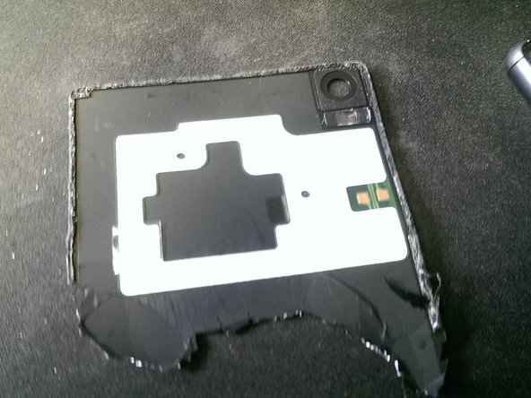

  8. How to replace a broken back cover on a Sony Xperia Z3, NFC sticker.: crwdns2935265:08crwdnd2935265:01crwdnd2935265:03crwdne2935265:0 How to replace a broken back cover on a Sony Xperia Z3, NFC sticker.: crwdns2935265:08crwdnd2935265:02crwdnd2935265:03crwdne2935265:0 How to replace a broken back cover on a Sony Xperia Z3, NFC sticker.: crwdns2935265:08crwdnd2935265:03crwdnd2935265:03crwdne2935265:0
    • Be sure to clean all the glass! Use tape to carefully pick up the small pieces.

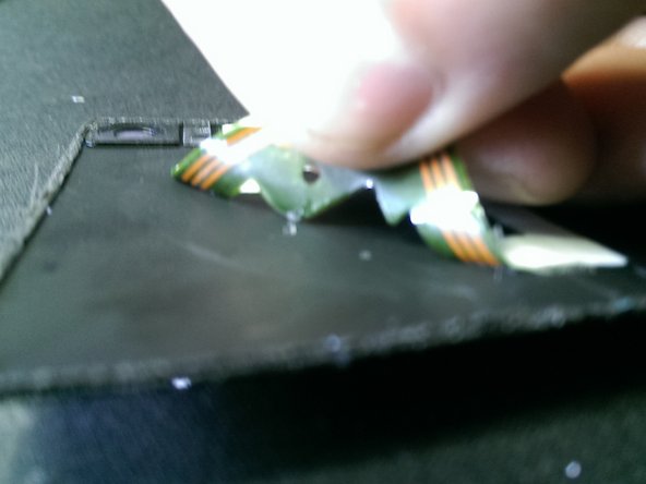

    • We still need to remove the NFC sticker to place in the new cover.
    • Carefully peel it off the old cover.
  9. How to replace a broken back cover on a Sony Xperia Z3, Placing the NFC sticker.: crwdns2935265:09crwdnd2935265:01crwdnd2935265:03crwdne2935265:0 How to replace a broken back cover on a Sony Xperia Z3, Placing the NFC sticker.: crwdns2935265:09crwdnd2935265:02crwdnd2935265:03crwdne2935265:0 How to replace a broken back cover on a Sony Xperia Z3, Placing the NFC sticker.: crwdns2935265:09crwdnd2935265:03crwdnd2935265:03crwdne2935265:0

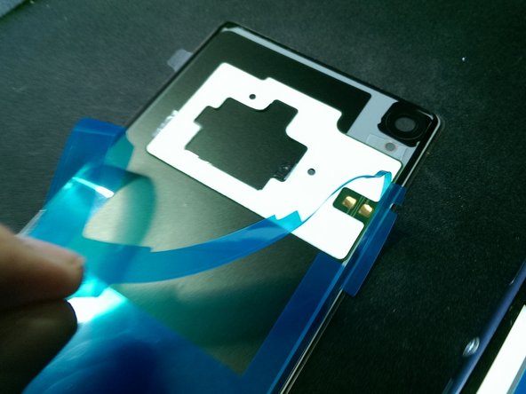

    • Place the NFC sticker in the free space in the tape on the inside of the new cover.
    • Press it down.
    • The contact sensitive area on the sticker will line up with the connectors on the motherboard.
  10. How to replace a broken back cover on a Sony Xperia Z3, The new cover.: crwdns2935265:010crwdnd2935265:01crwdnd2935265:03crwdne2935265:0 How to replace a broken back cover on a Sony Xperia Z3, The new cover.: crwdns2935265:010crwdnd2935265:02crwdnd2935265:03crwdne2935265:0 How to replace a broken back cover on a Sony Xperia Z3, The new cover.: crwdns2935265:010crwdnd2935265:03crwdnd2935265:03crwdne2935265:0
    • This is our new cover. Why not a new color? Not too expensive on eBay. This is an aftermarket version.
    • Peel off the protective plastic.

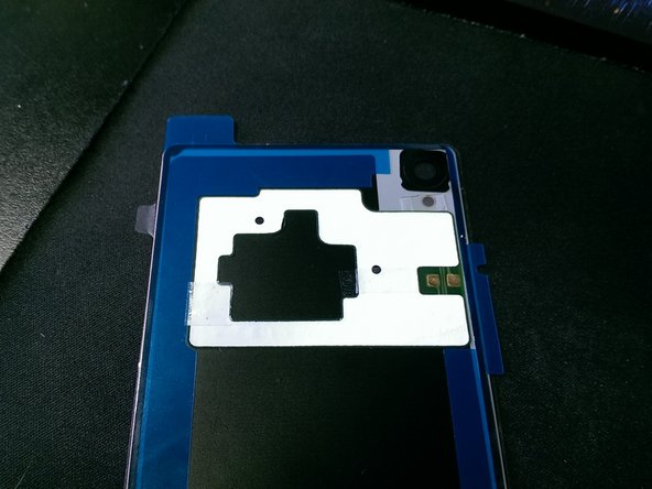

  11. How to replace a broken back cover on a Sony Xperia Z3, Placing the new cover.: crwdns2935265:011crwdnd2935265:01crwdnd2935265:02crwdne2935265:0 How to replace a broken back cover on a Sony Xperia Z3, Placing the new cover.: crwdns2935265:011crwdnd2935265:02crwdnd2935265:02crwdne2935265:0
    • Line the cover up with one of the corners and align it along the long edge.
    • Before you drop it in, you can make small adjustment to line it up with the opposite corner.
    • Gently press it down along all edges and about two thirds down, where the cover sticks to the battery.
