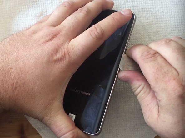

  2. How to replace Samsung Galaxy Note 5 motherboard, Remove the Galaxy Note 5 battery door.: crwdns2935265:02crwdnd2935265:01crwdnd2935265:02crwdne2935265:0 How to replace Samsung Galaxy Note 5 motherboard, Remove the Galaxy Note 5 battery door.: crwdns2935265:02crwdnd2935265:02crwdnd2935265:02crwdne2935265:0
    • Run the hair drier or heat gun around the edges of Note 5 on the back to soften the adhesive.
    • Gently pry up to release the battery cover. Be patient on this step as the battery cover is glued by strong adhesive.

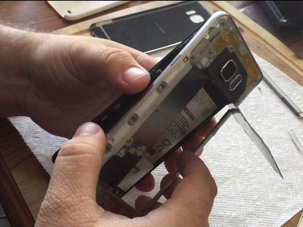

  3. How to replace Samsung Galaxy Note 5 motherboard, Release the Galaxy Note 5 rear housing.: crwdns2935265:03crwdnd2935265:01crwdnd2935265:03crwdne2935265:0 How to replace Samsung Galaxy Note 5 motherboard, Release the Galaxy Note 5 rear housing.: crwdns2935265:03crwdnd2935265:02crwdnd2935265:03crwdne2935265:0 How to replace Samsung Galaxy Note 5 motherboard, Release the Galaxy Note 5 rear housing.: crwdns2935265:03crwdnd2935265:03crwdnd2935265:03crwdne2935265:0
    • Undo the 20 screws in the rear housing.
    • Remove the SIM card tray.
    • Pry up the wireless charging chip. Be careful not to damage the fragile flex ribbon. Insert the case opening tool into the gap between rear housing and LCD assembly to release the rear housing.
