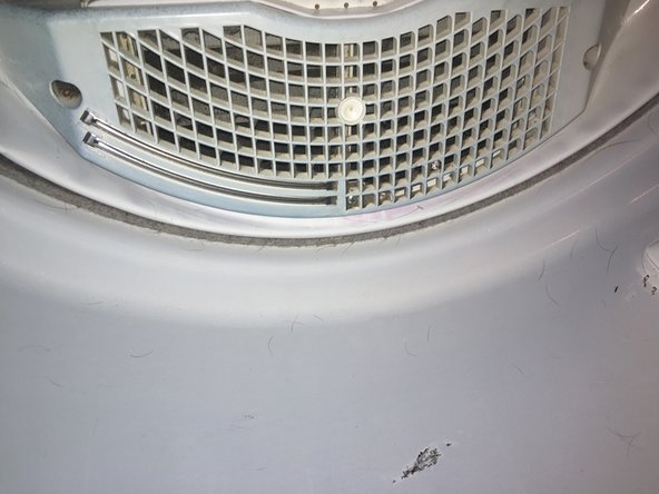

    • Remove the lint trap. You can see that there is a lot of lint in there. Once you take off the lint trap, you need to move it to the side. That way you have access to the trap and all the lint.
    • This is probably the reason the lint trap will not close.
