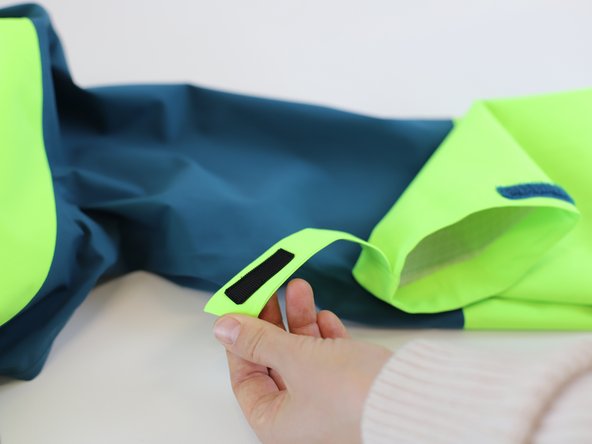

    • Check the defective area, and assess how big the repair will need to be.
    • Is the hook & loop part still mostly held in place with the original stitching? If so (like our example) then only a small repair is needed.

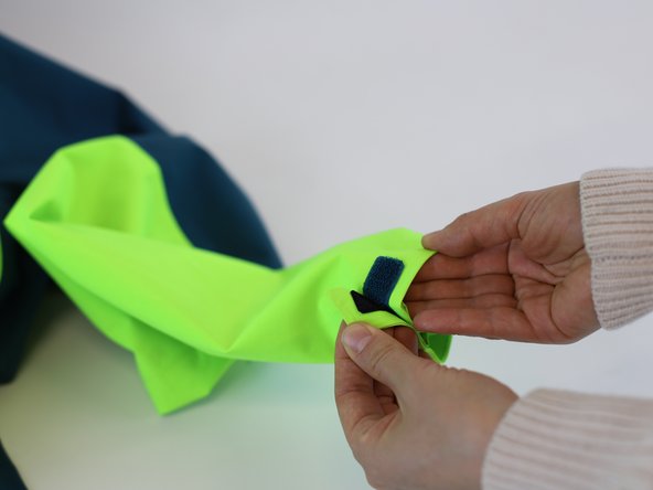

    • Cut away any damaged thread around the defect, to provide a clean base for the repair.
    • Then, position the item under the sewing machine, and make a small locking stitch with the forward & reverse function.
    • Tip: use the iFixit basic sewing resources for more help on sewing machine setup.
    • Continue sewing around the defective zone, following the line of the original thread.
