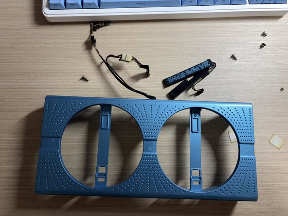

  1. How to repaint your graphic card, Preparation: crwdns2935265:02crwdnd2935265:01crwdnd2935265:01crwdne2935265:0
    • Remove all the accessories on your graphic card's casing(light strip, fans, fan cables)to prevent them from being damaged or covered up by the paint.
  2. How to repaint your graphic card, Preparation: crwdns2935265:03crwdnd2935265:01crwdnd2935265:01crwdne2935265:0
