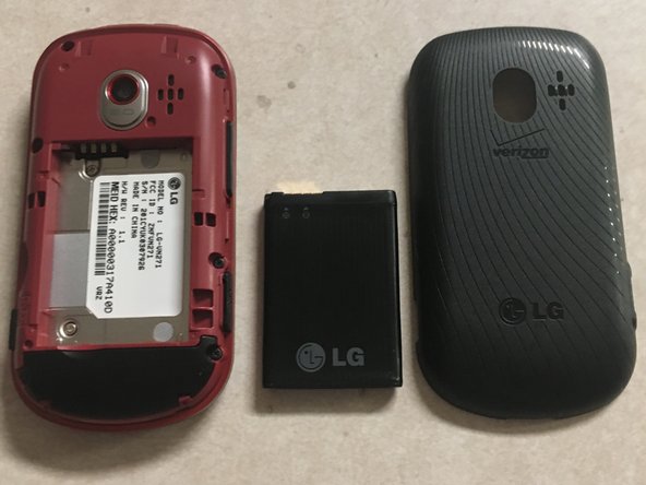

    • Start by flipping over the phone
  2. How to remove the back cover of the LG Extravert, Remove cover: crwdns2935265:02crwdnd2935265:01crwdnd2935265:02crwdne2935265:0 How to remove the back cover of the LG Extravert, Remove cover: crwdns2935265:02crwdnd2935265:02crwdnd2935265:02crwdne2935265:0
    • Remove the case on the back of the cell phone by pulling up on the little indent with your fingernail or a Spudger in the bottom of the phone.
  3. How to remove the back cover of the LG Extravert, Remove battery: crwdns2935265:03crwdnd2935265:01crwdnd2935265:03crwdne2935265:0 How to remove the back cover of the LG Extravert, Remove battery: crwdns2935265:03crwdnd2935265:02crwdnd2935265:03crwdne2935265:0 How to remove the back cover of the LG Extravert, Remove battery: crwdns2935265:03crwdnd2935265:03crwdnd2935265:03crwdne2935265:0
    • After you pull off the case, the battery is right under it. All you have to do is put you Spudger or fingernail into the indent on the right side of the battery and pull up.

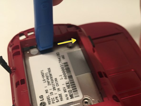

  5. How to remove the back cover of the LG Extravert, Remove the black cover.: crwdns2935265:05crwdnd2935265:01crwdnd2935265:01crwdne2935265:0
    • Using the Ifixit Opening Tool, insert it near the small indent, sliding it to the right. then pull towards the outside of the phone.
    • Be careful, as the Antennas are under the cover.
