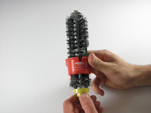

    • Push down on the two yellow tabs, and pull open the brush gate gently
  2. How to remove and clean iRobot Roomba 655 Pet Series brushes, Removing The Brushes: crwdns2935265:02crwdnd2935265:01crwdnd2935265:03crwdne2935265:0 How to remove and clean iRobot Roomba 655 Pet Series brushes, Removing The Brushes: crwdns2935265:02crwdnd2935265:02crwdnd2935265:03crwdne2935265:0 How to remove and clean iRobot Roomba 655 Pet Series brushes, Removing The Brushes: crwdns2935265:02crwdnd2935265:03crwdnd2935265:03crwdne2935265:0
    Microfiber Cleaning Cloths
    $3.99
    • Grab and pull up on the brushes to remove them
    • Use a damp microfiber or terry cloth to clean the rubber brush
  3. How to remove and clean iRobot Roomba 655 Pet Series brushes, Cleaning the Bristle Brush: crwdns2935265:03crwdnd2935265:01crwdnd2935265:03crwdne2935265:0 How to remove and clean iRobot Roomba 655 Pet Series brushes, Cleaning the Bristle Brush: crwdns2935265:03crwdnd2935265:02crwdnd2935265:03crwdne2935265:0 How to remove and clean iRobot Roomba 655 Pet Series brushes, Cleaning the Bristle Brush: crwdns2935265:03crwdnd2935265:03crwdnd2935265:03crwdne2935265:0
    • Use the included hair cutter to cut through hair that has gotten caught in the brush
    • Slide the brush cleaner down and back up until your brush is clean
