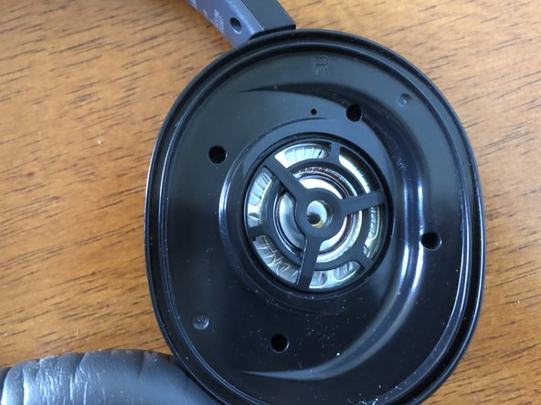

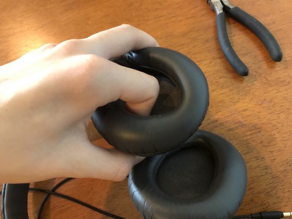

  2. How to reduce creaking plastic noises, Lower hinge - Remove ear pads: crwdns2935265:02crwdnd2935265:01crwdnd2935265:03crwdne2935265:0 How to reduce creaking plastic noises, Lower hinge - Remove ear pads: crwdns2935265:02crwdnd2935265:02crwdnd2935265:03crwdne2935265:0 How to reduce creaking plastic noises, Lower hinge - Remove ear pads: crwdns2935265:02crwdnd2935265:03crwdnd2935265:03crwdne2935265:0
    • Flip the headphones over so the earpads are facing you.
    • Grip the edge of the pad and gently pull up and away from the headphone.
    • The pad should come off relatively easily, be careful not to be too forceful and damage it.

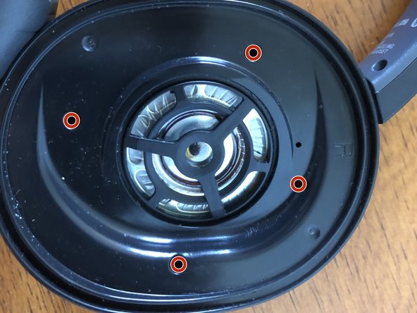

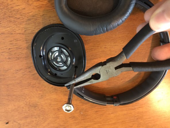

  3. How to reduce creaking plastic noises, Remove screws: crwdns2935265:03crwdnd2935265:01crwdnd2935265:03crwdne2935265:0 How to reduce creaking plastic noises, Remove screws: crwdns2935265:03crwdnd2935265:02crwdnd2935265:03crwdne2935265:0 How to reduce creaking plastic noises, Remove screws: crwdns2935265:03crwdnd2935265:03crwdnd2935265:03crwdne2935265:0
    • Use a #0 phillips screwdriver (Preferably JIS type instead of normal phillips) to remove the four screws.
    • You may need to use something such as pliers to increase the torque on the screws to get them out. Be careful not to damage them.

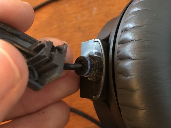

  5. How to reduce creaking plastic noises, Cleaning hinge: crwdns2935265:05crwdnd2935265:01crwdnd2935265:01crwdne2935265:0
    • Remove any contaminants from in and around the hinges, especially around the red O-rings.
  6. How to reduce creaking plastic noises, Reassembly: crwdns2935265:06crwdnd2935265:01crwdnd2935265:03crwdne2935265:0 How to reduce creaking plastic noises, Reassembly: crwdns2935265:06crwdnd2935265:02crwdnd2935265:03crwdne2935265:0 How to reduce creaking plastic noises, Reassembly: crwdns2935265:06crwdnd2935265:03crwdnd2935265:03crwdne2935265:0
    • Return the hinges to how they were originally by pushing the center part onto the hinge post with the wire going through it, then lifting the other hinge post and putting it in its hole.
    • Put the two halves of the headphone back together, and install the four screws.
    • Install the ear pad by fitting part of its edge in the lip around the edge of the headphone, and gently stretching it around so that it is completely fitted back in.

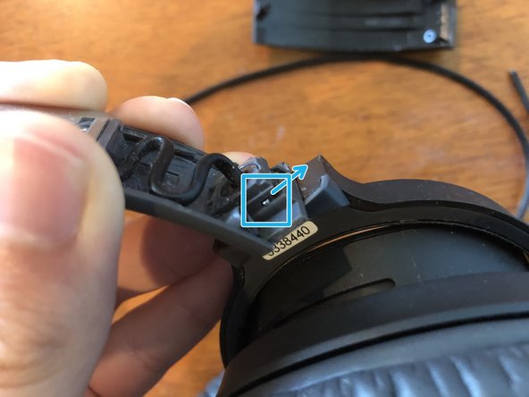

  7. How to reduce creaking plastic noises, Upper hinge - Disassembly: crwdns2935265:07crwdnd2935265:01crwdnd2935265:03crwdne2935265:0 How to reduce creaking plastic noises, Upper hinge - Disassembly: crwdns2935265:07crwdnd2935265:02crwdnd2935265:03crwdne2935265:0 How to reduce creaking plastic noises, Upper hinge - Disassembly: crwdns2935265:07crwdnd2935265:03crwdnd2935265:03crwdne2935265:0
    • Use the same tool and techniques as in step 3 to remove the three screws in the upper hinge cover.
    • Remove the back part of the upper hinge cover.
    • Remove the metal clip that holds the lower hinge assembly in place with a small screwdriver.

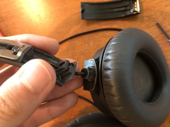

  8. How to reduce creaking plastic noises, Continued disassembly and cleaning: crwdns2935265:08crwdnd2935265:01crwdnd2935265:03crwdne2935265:0 How to reduce creaking plastic noises, Continued disassembly and cleaning: crwdns2935265:08crwdnd2935265:02crwdnd2935265:03crwdne2935265:0 How to reduce creaking plastic noises, Continued disassembly and cleaning: crwdns2935265:08crwdnd2935265:03crwdnd2935265:03crwdne2935265:0
    • Pull the lower hinge assembly away from the upper portion of the headphones, being careful not to damage the wire.
    • Clean the hinge in the same way as the lower hinge, making sure to clean the blue O-ring.
  9. How to reduce creaking plastic noises, Reassembly and conclusion: crwdns2935265:09crwdnd2935265:01crwdnd2935265:03crwdne2935265:0 How to reduce creaking plastic noises, Reassembly and conclusion: crwdns2935265:09crwdnd2935265:02crwdnd2935265:03crwdne2935265:0 How to reduce creaking plastic noises, Reassembly and conclusion: crwdns2935265:09crwdnd2935265:03crwdnd2935265:03crwdne2935265:0
    • Re-insert the lower hinge assembly into the upper portion, being careful to have it in the correct orientation without any added twists in the wire.
    • Install the metal clip to secure the lower hinge assembly.
    • Install the back cover to the upper hinge, and install the three screws.
    • Repeat steps 3 - 9 for the other side of the headphones to complete the hinge cleaning.
I don’t know how long this “repair“ will last, but it will at least temporarily make your headphones creak less when you are wearing them and move around.
