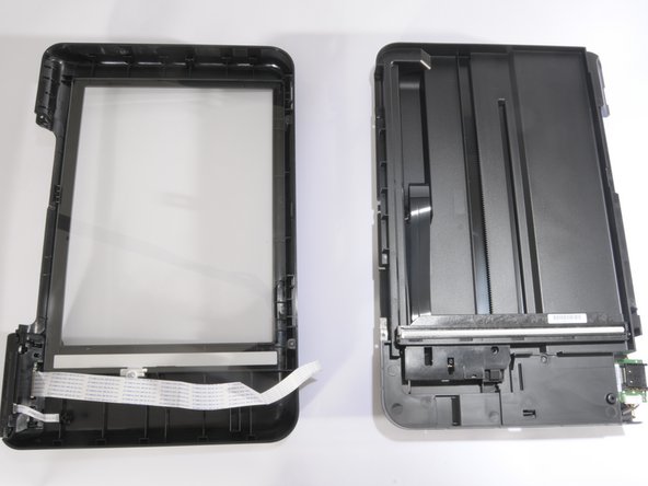

  8. How to realign HP Photosmart D110a scanner, Printer Hood: crwdns2935265:08crwdnd2935265:01crwdnd2935265:03crwdne2935265:0 How to realign HP Photosmart D110a scanner, Printer Hood: crwdns2935265:08crwdnd2935265:02crwdnd2935265:03crwdne2935265:0 How to realign HP Photosmart D110a scanner, Printer Hood: crwdns2935265:08crwdnd2935265:03crwdnd2935265:03crwdne2935265:0
    • Remove the single T-9 screw from the hood's underside, as shown.

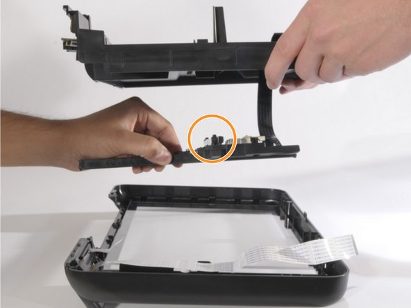

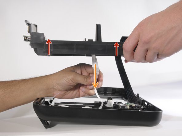

  9. How to realign HP Photosmart D110a scanner: crwdns2935265:09crwdnd2935265:01crwdnd2935265:02crwdne2935265:0 How to realign HP Photosmart D110a scanner: crwdns2935265:09crwdnd2935265:02crwdnd2935265:02crwdne2935265:0
    • With the screw removed, separate the two pieces of the hood by lifting it vertically.
    • Only lift the the top piece enough so that there is no tension applied to the ribbon cables shown.
    • Carefully pull down the white ribbon cable through the top piece of the hood.

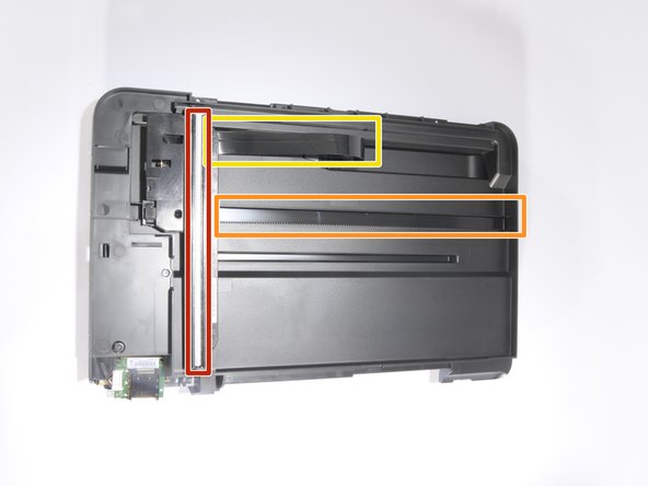

  11. How to realign HP Photosmart D110a scanner, How to realign HP Photosmart D110a scanner: crwdns2935265:011crwdnd2935265:01crwdnd2935265:03crwdne2935265:0 How to realign HP Photosmart D110a scanner, How to realign HP Photosmart D110a scanner: crwdns2935265:011crwdnd2935265:02crwdnd2935265:03crwdne2935265:0 How to realign HP Photosmart D110a scanner, How to realign HP Photosmart D110a scanner: crwdns2935265:011crwdnd2935265:03crwdnd2935265:03crwdne2935265:0
    • After having the hood removed and disassembled, locate the scanner.
    • Adjust the scanner wheel such that fits into the path.
    • If the black ribbon cable is twisted, untwist it so it appears as shown.
