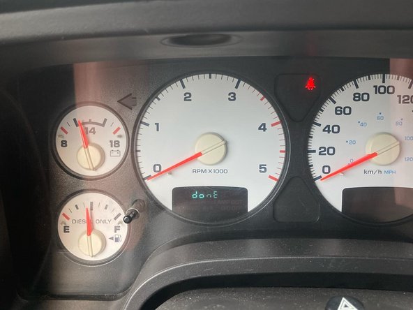

This guide demonstrates how to check malfunction indicator lamp (MIL) codes on dodge ram trucks
    1. How to read codes without code reader, Insert Key.: crwdns2935265:01crwdnd2935265:01crwdnd2935265:01crwdne2935265:0
      • Insert key into ignition switch
    2. How to read codes without code reader, Turn key to accessory mode: crwdns2935265:02crwdnd2935265:01crwdnd2935265:02crwdne2935265:0 How to read codes without code reader, Turn key to accessory mode: crwdns2935265:02crwdnd2935265:02crwdnd2935265:02crwdne2935265:0
      • Cycle the key from accessory to off 3 times
    3. How to read codes without code reader, Read codes displayed on dash: crwdns2935265:03crwdnd2935265:01crwdnd2935265:02crwdne2935265:0 How to read codes without code reader, Read codes displayed on dash: crwdns2935265:03crwdnd2935265:02crwdnd2935265:02crwdne2935265:0
      • Codes will be displayed on dash and when finished it will change to -------- and after that it will say done.
Follow these simple steps and bring something to write down your codes on.
