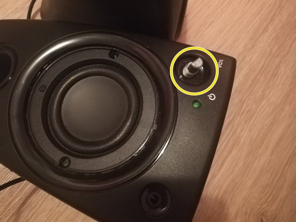

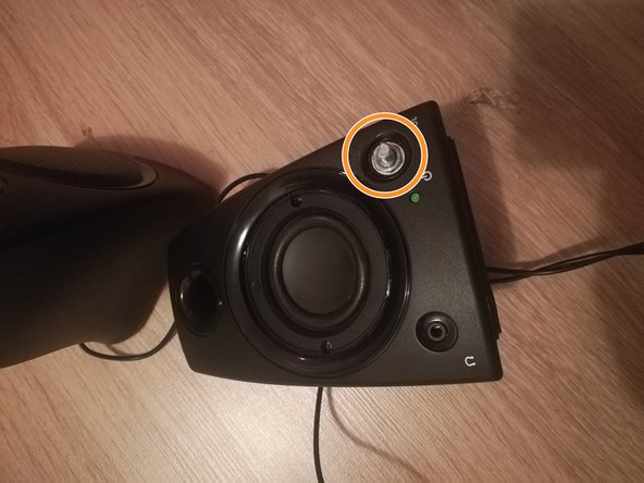

  4. How to open Logitech Z130 speakers, Remove the volume button and its nut: crwdns2935265:04crwdnd2935265:01crwdnd2935265:03crwdne2935265:0 How to open Logitech Z130 speakers, Remove the volume button and its nut: crwdns2935265:04crwdnd2935265:02crwdnd2935265:03crwdne2935265:0 How to open Logitech Z130 speakers, Remove the volume button and its nut: crwdns2935265:04crwdnd2935265:03crwdnd2935265:03crwdne2935265:0
    • Remove the volume button by pulling it
    • Unscrew the nut which is now exposed
    • Remove the nut and the spacer

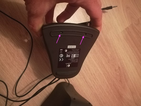

  5. How to open Logitech Z130 speakers, Remove the bottom screws: crwdns2935265:05crwdnd2935265:01crwdnd2935265:02crwdne2935265:0 How to open Logitech Z130 speakers, Remove the bottom screws: crwdns2935265:05crwdnd2935265:02crwdnd2935265:02crwdne2935265:0
    • Two front screws are hidden by a pad below the speaker.
    • Remove the pad
    • Remove the two bottom screws.
  6. How to open Logitech Z130 speakers, Open the speaker: crwdns2935265:06crwdnd2935265:01crwdnd2935265:01crwdne2935265:0
    • Job's done, you are now able to open the speaker by gently pulling the front part of it.
