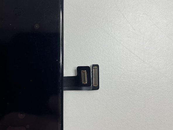

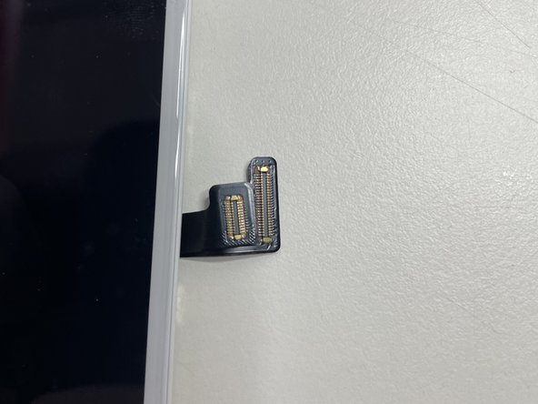

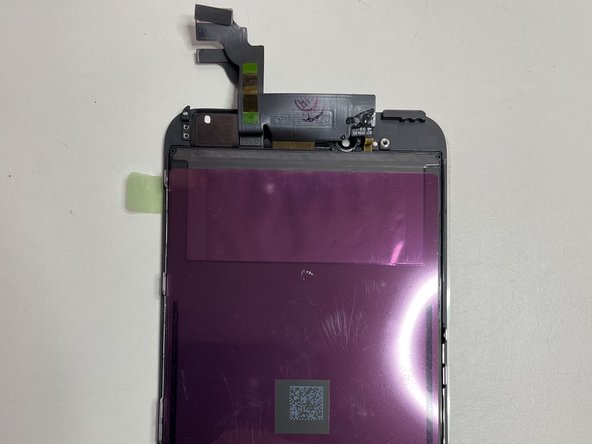

    • iPhone 5 has two parallel, horizontal screen connectors in the top right.. The larger, top one is the Digitizer connector, and the bottom, smaller one is the LCD connector. The vertical connection is used for camera and speaker functionality.

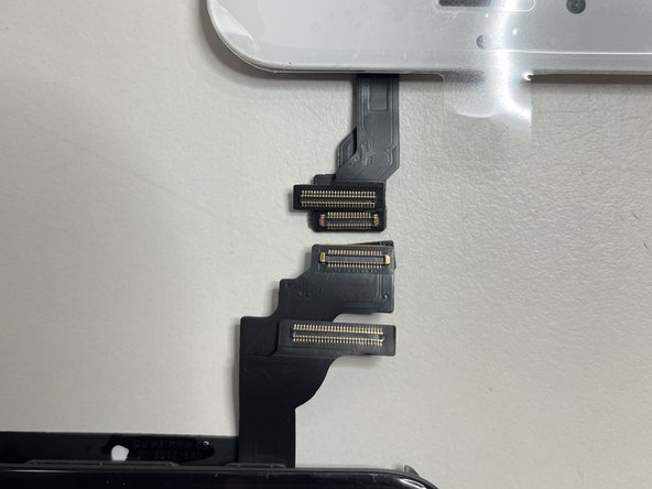

  3. How to identify your iPhone, Difference between 5 and 5c: crwdns2935265:03crwdnd2935265:01crwdnd2935265:01crwdne2935265:0
    • The main difference between the 5s and 5c is the 5s (left) is a thinner display than the 5c (right). The other smaller difference is that the digitizer connection is slightly larger.

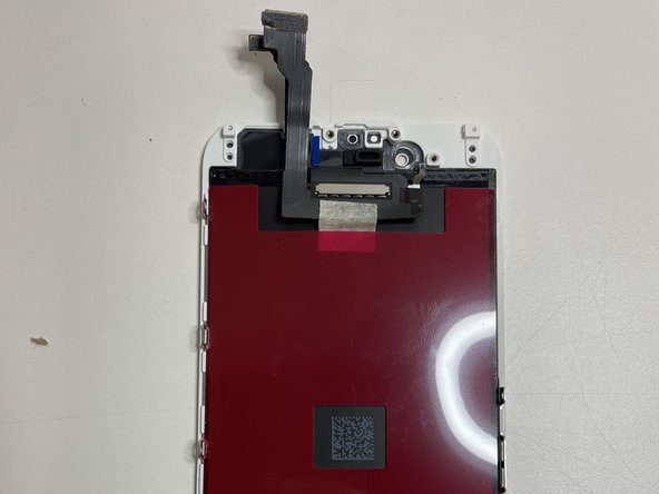

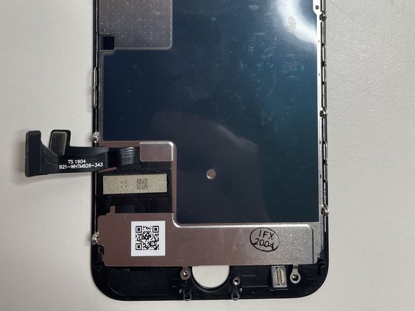

  6. How to identify your iPhone, iPhone SE: crwdns2935265:06crwdnd2935265:01crwdnd2935265:02crwdne2935265:0 How to identify your iPhone, iPhone SE: crwdns2935265:06crwdnd2935265:02crwdnd2935265:02crwdne2935265:0
    • iPhone SE is very similar to iPhone 5s.
    • You can tell between the iPhone SE and iPhone 5s by checking the back of the phone.

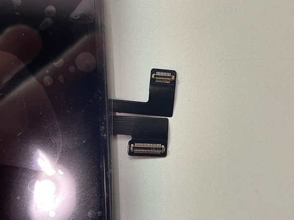

  7. How to identify your iPhone, iPhone 6: crwdns2935265:07crwdnd2935265:01crwdnd2935265:03crwdne2935265:0 How to identify your iPhone, iPhone 6: crwdns2935265:07crwdnd2935265:02crwdnd2935265:03crwdne2935265:0 How to identify your iPhone, iPhone 6: crwdns2935265:07crwdnd2935265:03crwdnd2935265:03crwdne2935265:0

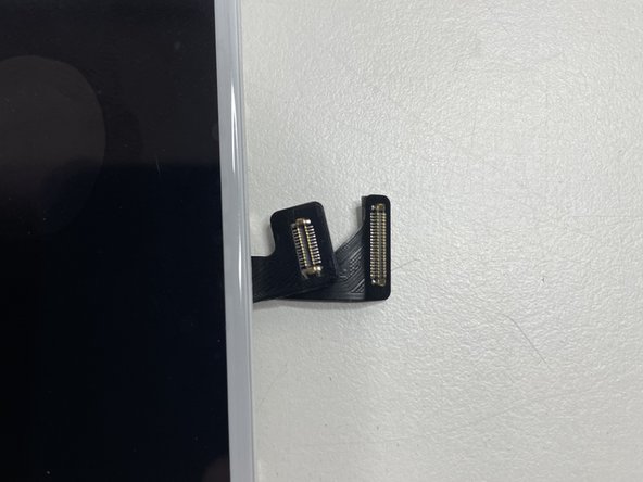

    • iPhone 6 has two parallel horizontal connectors in the top right. Following the same convention as the 5 series.

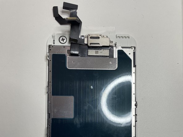

  9. How to identify your iPhone, iPhone 6s: crwdns2935265:09crwdnd2935265:01crwdnd2935265:03crwdne2935265:0 How to identify your iPhone, iPhone 6s: crwdns2935265:09crwdnd2935265:02crwdnd2935265:03crwdne2935265:0 How to identify your iPhone, iPhone 6s: crwdns2935265:09crwdnd2935265:03crwdnd2935265:03crwdne2935265:0
    • The iPhone 6s has vertical and horizontal connectors as well as an identifying mark on the back of the phone designating it as an s
  10. How to identify your iPhone, Difference between 6 and 6s: crwdns2935265:010crwdnd2935265:01crwdnd2935265:01crwdne2935265:0
    • The main way to tell between the 6 and 6s is to check the back of the phone. If you don't already have it open.

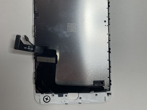

  13. How to identify your iPhone, iPhone 7 Plus: crwdns2935265:013crwdnd2935265:01crwdnd2935265:03crwdne2935265:0 How to identify your iPhone, iPhone 7 Plus: crwdns2935265:013crwdnd2935265:02crwdnd2935265:03crwdne2935265:0 How to identify your iPhone, iPhone 7 Plus: crwdns2935265:013crwdnd2935265:03crwdnd2935265:03crwdne2935265:0
    • iPhone 7 Plus is the same as the iPhone 7, except the screen and connectors are larger.

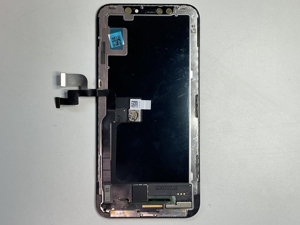

  17. How to identify your iPhone, iPhone X: crwdns2935265:017crwdnd2935265:01crwdnd2935265:03crwdne2935265:0 How to identify your iPhone, iPhone X: crwdns2935265:017crwdnd2935265:02crwdnd2935265:03crwdne2935265:0 How to identify your iPhone, iPhone X: crwdns2935265:017crwdnd2935265:03crwdnd2935265:03crwdne2935265:0
    • The iPhone X has two battery cells perpendicular to each other.

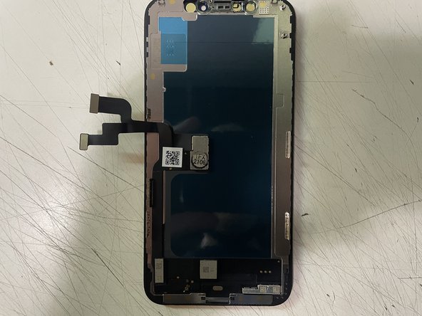

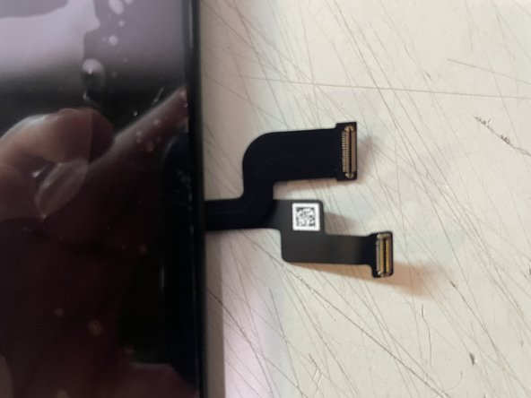

  19. How to identify your iPhone: crwdns2935265:019crwdnd2935265:01crwdnd2935265:01crwdne2935265:0
    • The iPhone X (Left) and Xs (Right) are extremely similar the only discernible way to tell the difference is to take a look at the back of the display. Look to the right of the camera bracket. The Xs will have a gold square and that is the only discernible difference.

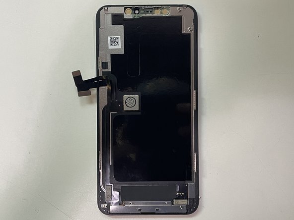

  20. How to identify your iPhone, iPhone XS Max: crwdns2935265:020crwdnd2935265:01crwdnd2935265:03crwdne2935265:0 How to identify your iPhone, iPhone XS Max: crwdns2935265:020crwdnd2935265:02crwdnd2935265:03crwdne2935265:0 How to identify your iPhone, iPhone XS Max: crwdns2935265:020crwdnd2935265:03crwdnd2935265:03crwdne2935265:0
    • The Xs Max is just a larger version of the Xs just as the 11 pro has the 11 pro max.

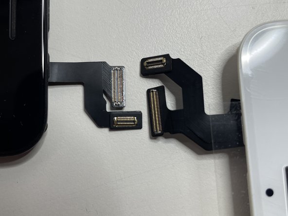

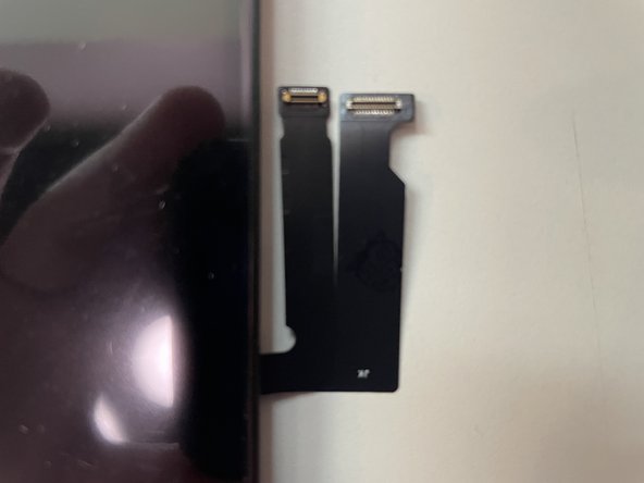

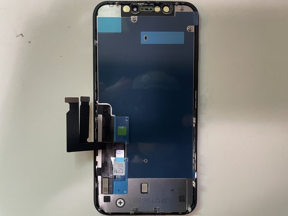

  23. How to identify your iPhone: crwdns2935265:023crwdnd2935265:01crwdnd2935265:01crwdne2935265:0
    • The XR (Left) and 11 (Right) are extremely similar design the only real difference is that their cables are swapped. They are both the LCD version of that generation.

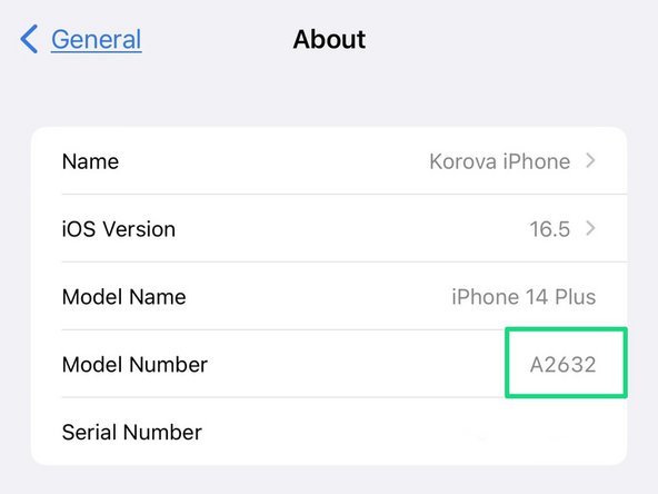

  26. How to identify your iPhone, If your iPhone is Working: crwdns2935265:026crwdnd2935265:01crwdnd2935265:02crwdne2935265:0 How to identify your iPhone, If your iPhone is Working: crwdns2935265:026crwdnd2935265:02crwdnd2935265:02crwdne2935265:0
    • Open Settings.
    • Go to General.
    • Go to About.
    • The Model Number is listed as a part number. Tap it to display the "A" Model ID.
