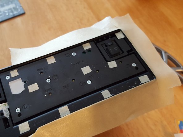

  5. How to fix touch buttons on Sony SRS-X7, Add a few drops of compatible adhesive in key areas.: crwdns2935265:05crwdnd2935265:01crwdnd2935265:01crwdne2935265:0
    • Put very small amounts of adhesive at the points identified with little squares of masking tape. Don't add the little squares of masking tape!
    • Silicone sealant works well.
    • Avoid putting adhesive over the areas directly above the touch pads or the grey light spreader on the upper-left.
    • Best to apply adhesive to the chassis, rather than the cover.
    • Keep in mind, adhesive spreads a lot, so little means VERY LITTLE.
  6. How to fix touch buttons on Sony SRS-X7, Apply masking tape to the cover and bezel.: crwdns2935265:06crwdnd2935265:01crwdnd2935265:02crwdne2935265:0 How to fix touch buttons on Sony SRS-X7, Apply masking tape to the cover and bezel.: crwdns2935265:06crwdnd2935265:02crwdnd2935265:02crwdne2935265:0
    • Apply masking tape to the cover.
    • Apply masking tape to the bezel.
    • This will simplify adhesive clean-up.

This was my first ifixit contribution. I hope you like it and find it useful. These speakers sound great when they work. It's a shame Sony chose to hasten the manufacturing process by use of large pads of double-sided tape. If they had gone with a liquid adhesive, or used die-cut double-sided tape that didn't cover the sensors, they could have saved a lot of headache for their customers.

Thank-you, this fixed the buttons for me, though it did take longer than 20 minutes! Saved my speaker as I couldn’t pair it with my new phone as none of the buttons worked. For anyone looking at this, I didn’t bother glueing the top panel back in at the end (paranoia, want to check the fix) - but as it is recessed it sits there quite nicely anyway. Just don’t use it upside-down ;)
