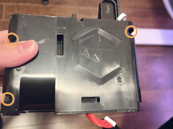

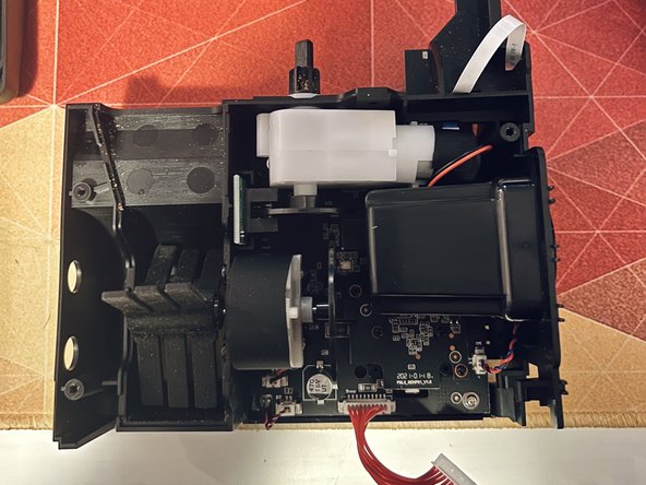

    • Once the controls are removed, you can simply slide the core of the device out of its shell.
    • You'll find 3 Philips screws (2 on the left, 1 on the right) to get inside the core.
  6. How to fix the main motor of Petcube Bites 2 Lite, Remove the motor: crwdns2935265:06crwdnd2935265:01crwdnd2935265:03crwdne2935265:0 How to fix the main motor of Petcube Bites 2 Lite, Remove the motor: crwdns2935265:06crwdnd2935265:02crwdnd2935265:03crwdne2935265:0 How to fix the main motor of Petcube Bites 2 Lite, Remove the motor: crwdns2935265:06crwdnd2935265:03crwdnd2935265:03crwdne2935265:0

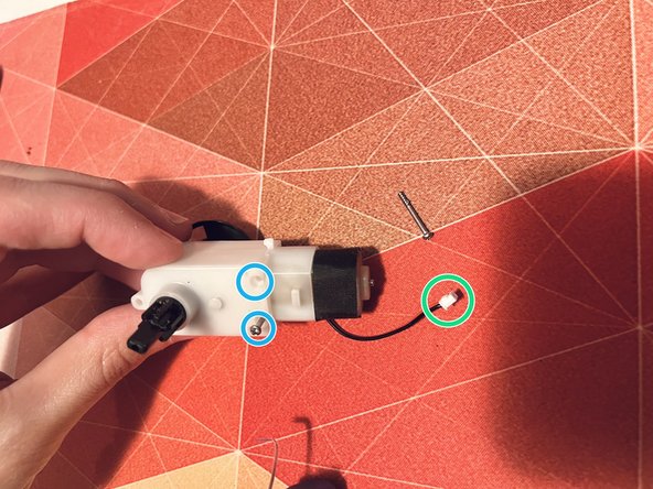

    • The 3 Philips screws holding the motor to the structure can be removed.

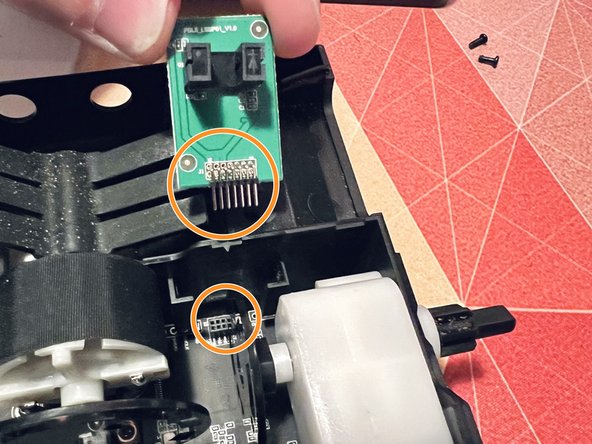

    • The motor won't slide out immediately – you'll also need to remove the encoder sensor. Just pull it out carefully from its socket.
    • While trying to slide the motor out, make sure to disconnect its cable from the main board.
    • The motor can then be disassembled by removing the 2 Philips screw holding its shell.

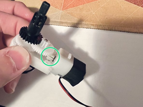

    • Inside the motor, just realign all the cogs together so that everything spins together.

This guide was super useful! Unfortunately, I found that the problem is that one of the gears broke off. Does anyone have any instructions on how to dismantle this type of motor in order to substitute the damaged gears? Thank you in advance!
Geraldine - crwdns2934203:0crwdne2934203:0
Same here. 8 tooth gear snapped in half. Is there a part number for it?
Clint - crwdns2934203:0crwdne2934203:0
Thank you so much for this video! It allowed me to repair my feeder. I had the same issue that others mentioned. Gear broke off the shaft of the motor. Feeder would work inconsistently, although I could hear the motor turning. Here's what I did. https://youtu.be/sg85Wmw_8oY?si=ioBROd2Y...
