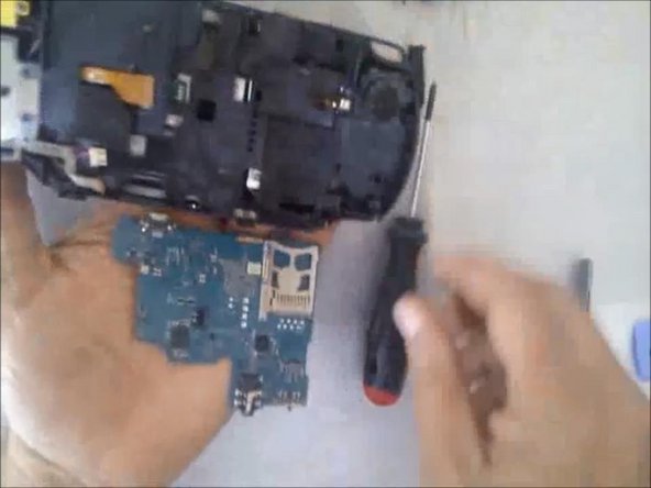

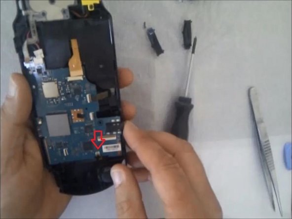

    • Let's start dismantling.
  2. How to fix the PSP E1000 psp e1000 WHITE SCREEN: crwdns2935265:02crwdnd2935265:01crwdnd2935265:03crwdne2935265:0 How to fix the PSP E1000 psp e1000 WHITE SCREEN: crwdns2935265:02crwdnd2935265:02crwdnd2935265:03crwdne2935265:0 How to fix the PSP E1000 psp e1000 WHITE SCREEN: crwdns2935265:02crwdnd2935265:03crwdnd2935265:03crwdne2935265:0
    • start by removing the top part and then *gently* "fold" it down to the bottom
  3. How to fix the PSP E1000 psp e1000 WHITE SCREEN: crwdns2935265:03crwdnd2935265:01crwdnd2935265:03crwdne2935265:0 How to fix the PSP E1000 psp e1000 WHITE SCREEN: crwdns2935265:03crwdnd2935265:02crwdnd2935265:03crwdne2935265:0 How to fix the PSP E1000 psp e1000 WHITE SCREEN: crwdns2935265:03crwdnd2935265:03crwdnd2935265:03crwdne2935265:0

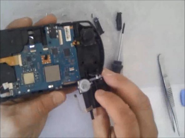

    • Disassembling the screen.
  4. How to fix the PSP E1000 psp e1000 WHITE SCREEN: crwdns2935265:04crwdnd2935265:01crwdnd2935265:02crwdne2935265:0 How to fix the PSP E1000 psp e1000 WHITE SCREEN: crwdns2935265:04crwdnd2935265:02crwdnd2935265:02crwdne2935265:0
    • Remove this screw.

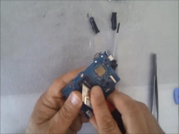

    • Insert wisdom here.
  6. How to fix the PSP E1000 psp e1000 WHITE SCREEN: crwdns2935265:06crwdnd2935265:01crwdnd2935265:03crwdne2935265:0 How to fix the PSP E1000 psp e1000 WHITE SCREEN: crwdns2935265:06crwdnd2935265:02crwdnd2935265:03crwdne2935265:0 How to fix the PSP E1000 psp e1000 WHITE SCREEN: crwdns2935265:06crwdnd2935265:03crwdnd2935265:03crwdne2935265:0
  7. How to fix the PSP E1000 psp e1000 WHITE SCREEN: crwdns2935265:07crwdnd2935265:01crwdnd2935265:03crwdne2935265:0 How to fix the PSP E1000 psp e1000 WHITE SCREEN: crwdns2935265:07crwdnd2935265:02crwdnd2935265:03crwdne2935265:0 How to fix the PSP E1000 psp e1000 WHITE SCREEN: crwdns2935265:07crwdnd2935265:03crwdnd2935265:03crwdne2935265:0

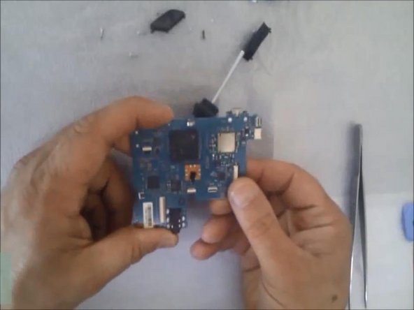

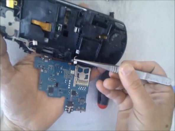

    • Carefully disconnect the battery connector!
  8. How to fix the PSP E1000 psp e1000 WHITE SCREEN: crwdns2935265:08crwdnd2935265:01crwdnd2935265:03crwdne2935265:0 How to fix the PSP E1000 psp e1000 WHITE SCREEN: crwdns2935265:08crwdnd2935265:02crwdnd2935265:03crwdne2935265:0 How to fix the PSP E1000 psp e1000 WHITE SCREEN: crwdns2935265:08crwdnd2935265:03crwdnd2935265:03crwdne2935265:0
    • Remove the thermal tape.
  9. How to fix the PSP E1000 psp e1000 WHITE SCREEN: crwdns2935265:09crwdnd2935265:01crwdnd2935265:02crwdne2935265:0 How to fix the PSP E1000 psp e1000 WHITE SCREEN: crwdns2935265:09crwdnd2935265:02crwdnd2935265:02crwdne2935265:0
    • You must resolder main processor with Rework Station (this is special equipment).
  10. How to fix the PSP E1000 psp e1000 WHITE SCREEN: crwdns2935265:010crwdnd2935265:01crwdnd2935265:03crwdne2935265:0 How to fix the PSP E1000 psp e1000 WHITE SCREEN: crwdns2935265:010crwdnd2935265:02crwdnd2935265:03crwdne2935265:0 How to fix the PSP E1000 psp e1000 WHITE SCREEN: crwdns2935265:010crwdnd2935265:03crwdnd2935265:03crwdne2935265:0
