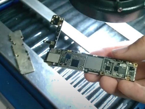

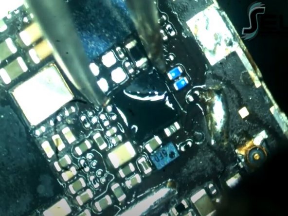

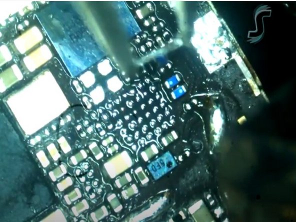

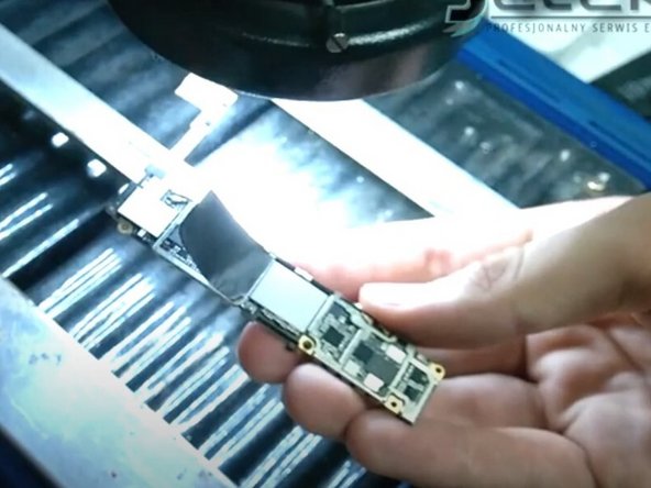

  45. How to fix iTunes error 9 in an Apple iPhone 6s, How to fix iTunes error 9 in an Apple iPhone 6s: crwdns2935265:045crwdnd2935265:01crwdnd2935265:03crwdne2935265:0 How to fix iTunes error 9 in an Apple iPhone 6s, How to fix iTunes error 9 in an Apple iPhone 6s: crwdns2935265:045crwdnd2935265:02crwdnd2935265:03crwdne2935265:0 How to fix iTunes error 9 in an Apple iPhone 6s, How to fix iTunes error 9 in an Apple iPhone 6s: crwdns2935265:045crwdnd2935265:03crwdnd2935265:03crwdne2935265:0
    • Remove the protective cover from the logic board.
    • Remove the black sticker from the logic board.
  46. How to fix iTunes error 9 in an Apple iPhone 6s: crwdns2935265:046crwdnd2935265:01crwdnd2935265:03crwdne2935265:0 How to fix iTunes error 9 in an Apple iPhone 6s: crwdns2935265:046crwdnd2935265:02crwdnd2935265:03crwdne2935265:0 How to fix iTunes error 9 in an Apple iPhone 6s: crwdns2935265:046crwdnd2935265:03crwdnd2935265:03crwdne2935265:0
    • Place a heat shield over the other parts of the motherboard to avoid overheating.
    • Heat the affected area with a heat gun to reflow the solder.
    • Reflowing heats up all the soldering joints in an area so they become liquid enough to reinforce the bonds. This allows electricity to flow through the bond without unexpected resistance.
  47. How to fix iTunes error 9 in an Apple iPhone 6s: crwdns2935265:047crwdnd2935265:01crwdnd2935265:01crwdne2935265:0
    • Re-solder a new tristar chip onto the logic board.
    • Apply a small amount of isopropyl alcohol to the areas where flux was applied.
    • The isopropyl alcohol will clean any remaining flux that was not burned off during the heating process.
