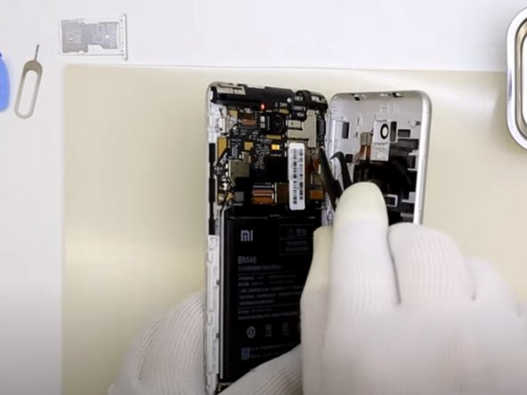

      • Insert a putty knife or opening tool into the seam between the phone's back cover and front cover.
      • Run the opening tool along the seam to loosen the back cover.
      • It may take quite a bit of prying and wiggling to remove the back cover.
      • Open the back cover slightly so that you can see the flex cable connected between both halves of the phone.
      • The flex cable connects towards the top of the phone near the front-facing camera. To avoid tearing the cable, pull the back cover off gently.
    3. How to fix boot loop in Xiaomi Redmi Note 3: crwdns2935265:03crwdnd2935265:01crwdnd2935265:03crwdne2935265:0 How to fix boot loop in Xiaomi Redmi Note 3: crwdns2935265:03crwdnd2935265:02crwdnd2935265:03crwdne2935265:0 How to fix boot loop in Xiaomi Redmi Note 3: crwdns2935265:03crwdnd2935265:03crwdnd2935265:03crwdne2935265:0
      • Disconnect the flex cable using the flat end of a spudger or a pair of tweezers.
      • Remove the phone's back cover.
      • To reconnect the flex cable during reassembly, angle the back cover until the flex cable lines up over its socket. Use the flat end of a spudger to snap the cable in place by gently pressing straight down.

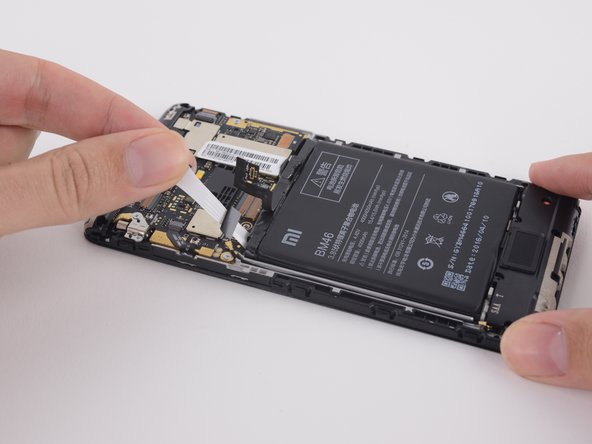

      • Peel back the barcode sticker so that it is disconnected from the battery.
      • Use your fingers to grasp the black battery adhesive tab and pull outwards firmly until the entire adhesive strip is released.
      • Repeat for the second battery adhesive strip.
    9. How to fix boot loop in Xiaomi Redmi Note 3: crwdns2935265:09crwdnd2935265:01crwdnd2935265:02crwdne2935265:0 How to fix boot loop in Xiaomi Redmi Note 3: crwdns2935265:09crwdnd2935265:02crwdnd2935265:02crwdne2935265:0

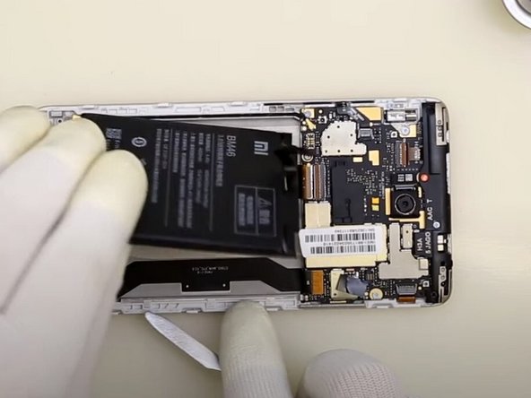

      • Insert the flat end of a spudger underneath the battery.
      • Use your fingers to remove the battery.

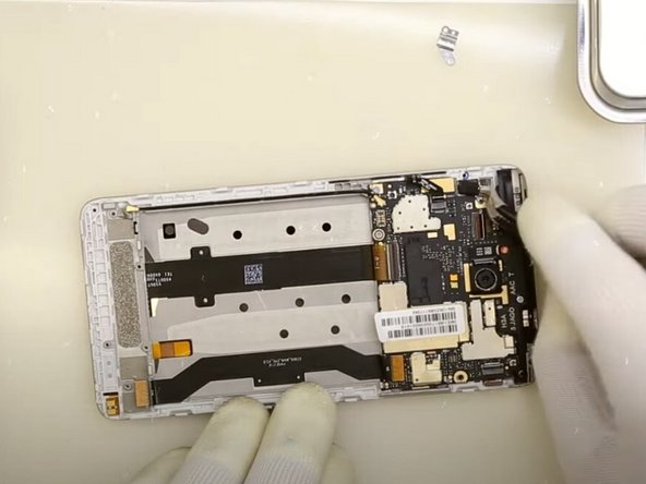

      • Use a spudger to disconnect all marked ribbon cables.
    11. How to fix boot loop in Xiaomi Redmi Note 3: crwdns2935265:011crwdnd2935265:01crwdnd2935265:02crwdne2935265:0 How to fix boot loop in Xiaomi Redmi Note 3: crwdns2935265:011crwdnd2935265:02crwdnd2935265:02crwdne2935265:0

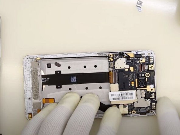

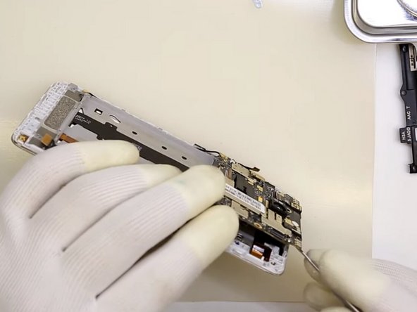

      • Use a Phillips #00 screwdriver to remove the eight screws fastening the motherboard to the phone's interior.
    12. How to fix boot loop in Xiaomi Redmi Note 3: crwdns2935265:012crwdnd2935265:01crwdnd2935265:02crwdne2935265:0 How to fix boot loop in Xiaomi Redmi Note 3: crwdns2935265:012crwdnd2935265:02crwdnd2935265:02crwdne2935265:0
      • Use a pair of tweezers to remove the small metal piece from the top of the motherboard.
    13. How to fix boot loop in Xiaomi Redmi Note 3: crwdns2935265:013crwdnd2935265:01crwdnd2935265:03crwdne2935265:0 How to fix boot loop in Xiaomi Redmi Note 3: crwdns2935265:013crwdnd2935265:02crwdnd2935265:03crwdne2935265:0 How to fix boot loop in Xiaomi Redmi Note 3: crwdns2935265:013crwdnd2935265:03crwdnd2935265:03crwdne2935265:0

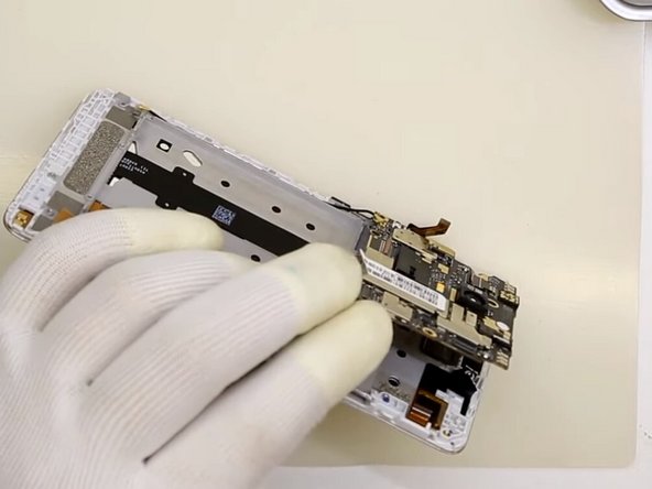

      • Slide an opening tool underneath the plastic assembly covering the upper portion of the motherboard.
      • Use your fingers or the opening tool to remove the plastic covering.
    14. How to fix boot loop in Xiaomi Redmi Note 3: crwdns2935265:014crwdnd2935265:01crwdnd2935265:02crwdne2935265:0 How to fix boot loop in Xiaomi Redmi Note 3: crwdns2935265:014crwdnd2935265:02crwdnd2935265:02crwdne2935265:0
      • Slide an opening tool or the flat end of a spudger underneath the motherboard.
      • Pry upwards to loosen the motherboard from the phone's front cover.
    15. How to fix boot loop in Xiaomi Redmi Note 3: crwdns2935265:015crwdnd2935265:01crwdnd2935265:03crwdne2935265:0 How to fix boot loop in Xiaomi Redmi Note 3: crwdns2935265:015crwdnd2935265:02crwdnd2935265:03crwdne2935265:0 How to fix boot loop in Xiaomi Redmi Note 3: crwdns2935265:015crwdnd2935265:03crwdnd2935265:03crwdne2935265:0
      • Gently lift the motherboard from its slot.
      • Use the flat end of a spudger to disconnect the cable from the bottom of the motherboard.
    16. How to fix boot loop in Xiaomi Redmi Note 3: crwdns2935265:016crwdnd2935265:01crwdnd2935265:02crwdne2935265:0 How to fix boot loop in Xiaomi Redmi Note 3: crwdns2935265:016crwdnd2935265:02crwdnd2935265:02crwdne2935265:0
      • Use your fingers to remove the motherboard.

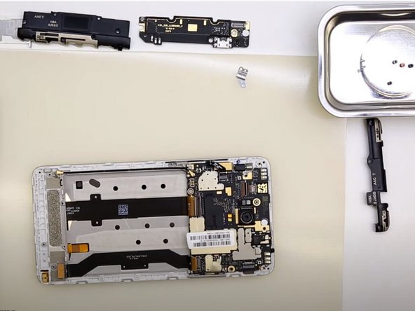

    1. How to fix boot loop in Xiaomi Redmi Note 3, How to fix boot loop in Xiaomi Redmi Note 3: crwdns2935265:017crwdnd2935265:01crwdnd2935265:02crwdne2935265:0 How to fix boot loop in Xiaomi Redmi Note 3, How to fix boot loop in Xiaomi Redmi Note 3: crwdns2935265:017crwdnd2935265:02crwdnd2935265:02crwdne2935265:0
      • Visually inspect the phone's motherboard for any corrosion.
      • Apply a small amount of flux to the corroded parts of the motherboard using a brush.
      • Wipe away any corrosion using a soft brush.
    2. How to fix boot loop in Xiaomi Redmi Note 3: crwdns2935265:018crwdnd2935265:01crwdnd2935265:01crwdne2935265:0
      • Place a heat shield over the other parts of the motherboard to avoid overheating.
      • Heat the affected area with a heat gun to reflow the solder.
      • Reflowing heats up all the soldering joints in an area so they become liquid enough to reinforce the bonds. This allows electricity to flow through the bond without unexpected resistance.
    3. How to fix boot loop in Xiaomi Redmi Note 3: crwdns2935265:019crwdnd2935265:01crwdnd2935265:01crwdne2935265:0
      • Apply a small amount of isopropyl alcohol to the affected areas.
      • The isopropyl alcohol will clean any remaining flux that was not burned off during the heating process.
    4. How to fix boot loop in Xiaomi Redmi Note 3: crwdns2935265:020crwdnd2935265:01crwdnd2935265:01crwdne2935265:0
      • Repeat steps 11-13 for any other areas of the motherboard that are corroded or rusty.
