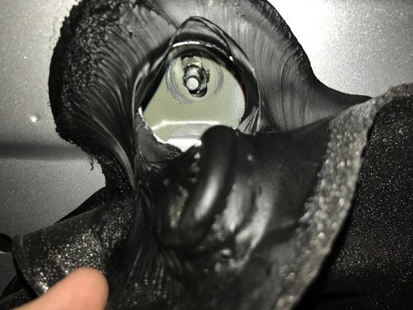

  7. How to fix a rattling window, E46 M3, Inspect the post: crwdns2935265:08crwdnd2935265:01crwdnd2935265:02crwdne2935265:0 How to fix a rattling window, E46 M3, Inspect the post: crwdns2935265:08crwdnd2935265:02crwdnd2935265:02crwdne2935265:0
    • Very gently, peel back the vapor barrier to expose the retaining bolt.
    • Roll the window up.
    • The tar-like substance used to seal the vapor barrier to the door frame WILL release itself to a gentle pull, but it is EXTREMELY sticky, and too much pulling will tear your barrier. Slow and steady is the name of the game!
    • Inspect the bolt. It is probably missing a nut!
  8. How to fix a rattling window, E46 M3, Inspect the other bolt: crwdns2935265:09crwdnd2935265:01crwdnd2935265:01crwdne2935265:0
    • While you're in here, inspect and tighten the bottom bolt.
  9. How to fix a rattling window, E46 M3, Find and replace!: crwdns2935265:010crwdnd2935265:01crwdnd2935265:01crwdne2935265:0
    • Look in the bottom of your door and locate the nut that fell off that top bolt.
    • Replace the nut onto the upper bolt and tighten.
    • In a pinch, you can use a little bit of that tarry substance to temporarily paste the nut to your fingertip in order to screw it on to the bolt.
    • Ta da! Now closing the door sounds great!
