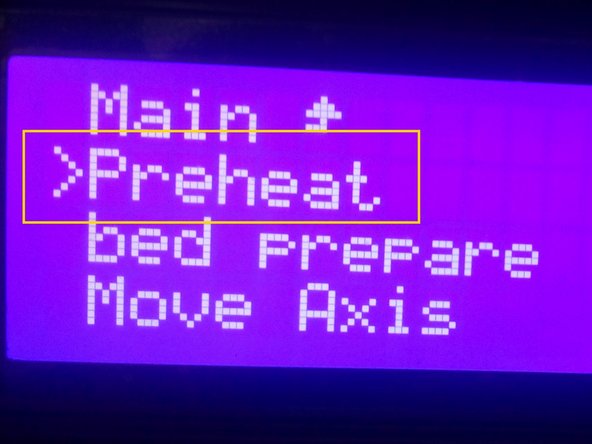

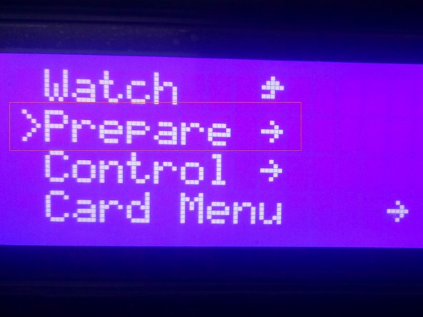

    • Go to prepare .
    • Click the option , preheat.
    • Go back to the main menu, check whether the nozzle temperature is increasing to the set temperature.

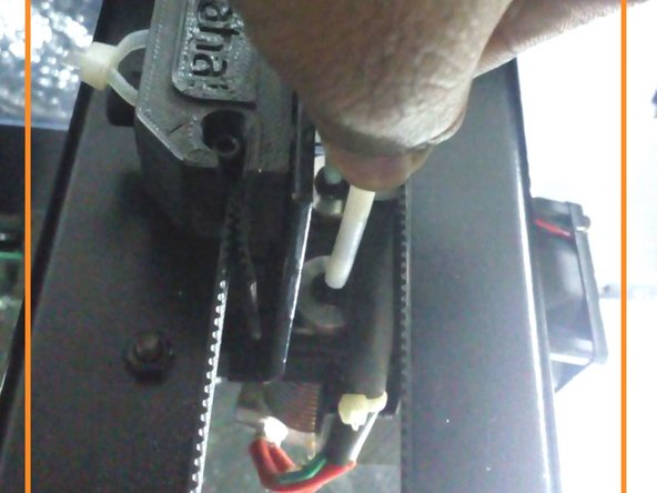

  2. How to fix a jammed nozzle on a ProtoCentre 999, REMOVE TEFLON TUBE: crwdns2935265:02crwdnd2935265:01crwdnd2935265:03crwdne2935265:0 How to fix a jammed nozzle on a ProtoCentre 999, REMOVE TEFLON TUBE: crwdns2935265:02crwdnd2935265:02crwdnd2935265:03crwdne2935265:0 How to fix a jammed nozzle on a ProtoCentre 999, REMOVE TEFLON TUBE: crwdns2935265:02crwdnd2935265:03crwdnd2935265:03crwdne2935265:0
    • Remove the teflon tube from the nozzle block.

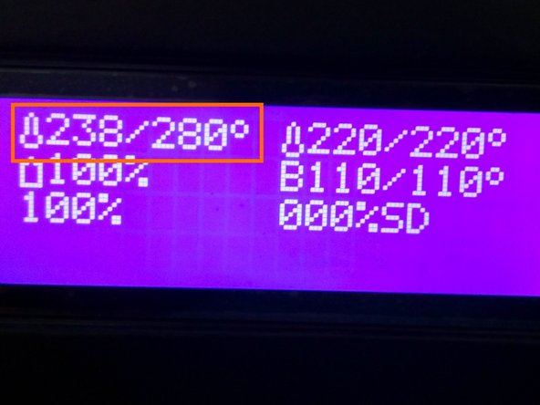

    • In some case the teflon tube will not come out free. In this case, increase the temperature to 280 deg and try to remove the teflon tube.

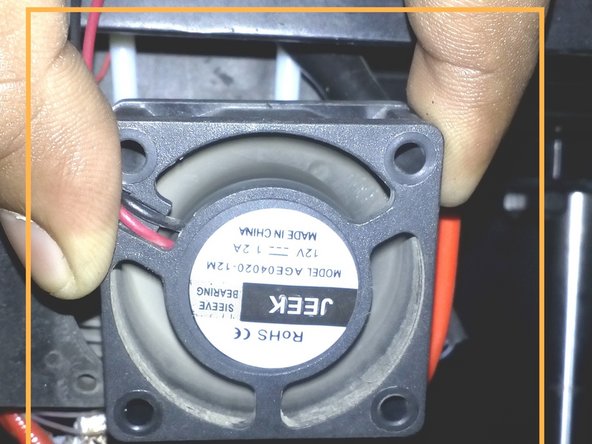

    • In some case, jammed filament will not come out free. At this case , increase the nozzle temperature to 280deg and remove the nozzle cooler fan.
    • And try to clean the nozzle from the top with the help of a needle and a nose plier.

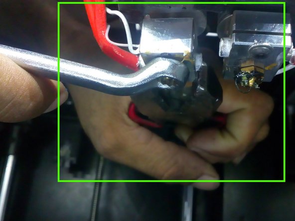

    • If the nozzle is again not clean, try to clean the nozzle by removing the nozzle tip with the help of a nose plier and spanner. Again clean it with the help of a needle.
    • NOTE: Be careful while removing the nozzle tip. If you extract more pressure on the nozzle tip, it may break. So be careful while doing it.

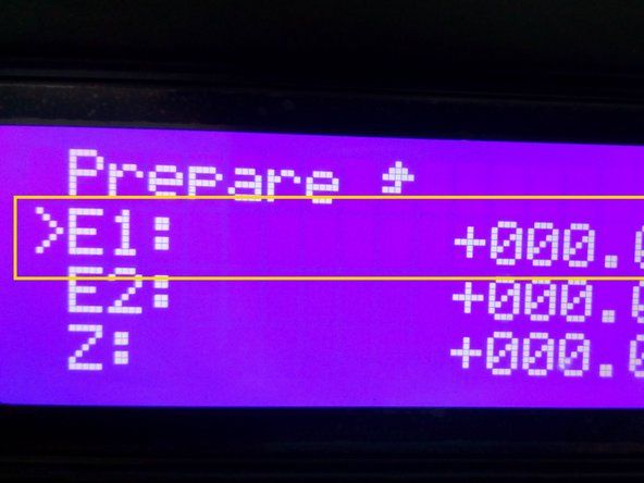

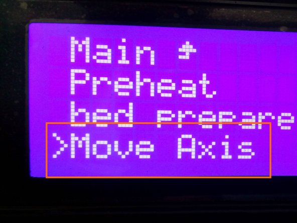

    • Go to prepare
    • click on move axis
    • Select the extrude
    • Rotate the knob in clock wise direction and check the extrusion.
