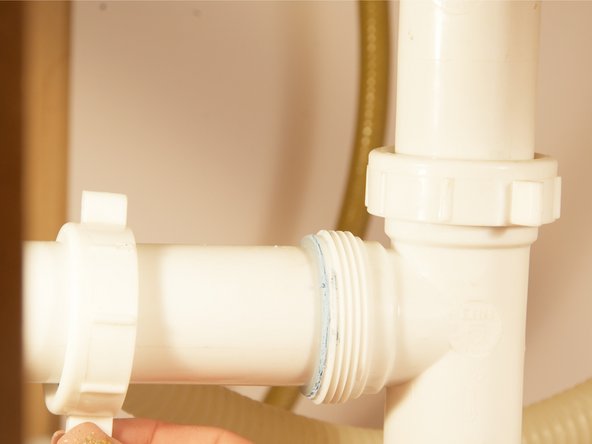

  4. How to fix a clogged garbage disposal: crwdns2935265:04crwdnd2935265:01crwdnd2935265:02crwdne2935265:0 How to fix a clogged garbage disposal: crwdns2935265:04crwdnd2935265:02crwdnd2935265:02crwdne2935265:0
    • Disconnect the garbage disposal pipe from the sewer pipe.
    • There may be excess water in this part of the pipe so place the bucket underneath.

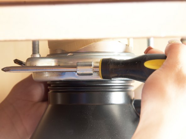

  5. How to fix a clogged garbage disposal: crwdns2935265:05crwdnd2935265:01crwdnd2935265:02crwdne2935265:0 How to fix a clogged garbage disposal: crwdns2935265:05crwdnd2935265:02crwdnd2935265:02crwdne2935265:0
    • Using two screwdrivers, place them in the hooks on the top of the garbage disposal and push against them clockwise.

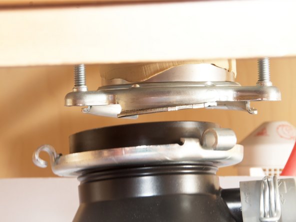

  6. How to fix a clogged garbage disposal: crwdns2935265:06crwdnd2935265:01crwdnd2935265:02crwdne2935265:0 How to fix a clogged garbage disposal: crwdns2935265:06crwdnd2935265:02crwdnd2935265:02crwdne2935265:0
    • Carefully bring down the garbage disposal from where it was connected to the sink.
