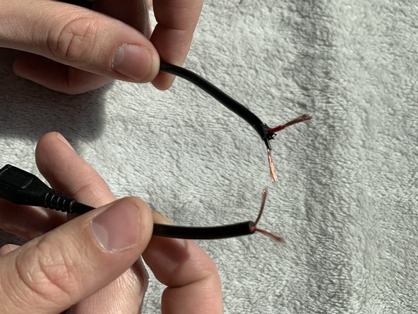

    • Cut out the part where the wire is broken using a pair of wire cutters.
  3. How to fix a break in a Belkin Lightning Charger Cable, Strip the cable: crwdns2935265:03crwdnd2935265:01crwdnd2935265:01crwdne2935265:0
    Flush Cutter
    $29.99
    • Strip off about 3cm of the black insulation with the wire strippers to expose the red and black wire on both parts of the cable.
    • You can use your flush cutters or a knife as an improvised wire stripper by cutting just enough so that you don't damage the small wires inside and pulling the insulation off.
    • Be safe when using the flush cutters or a knife: Pull away from your face and body when stripping wires.
