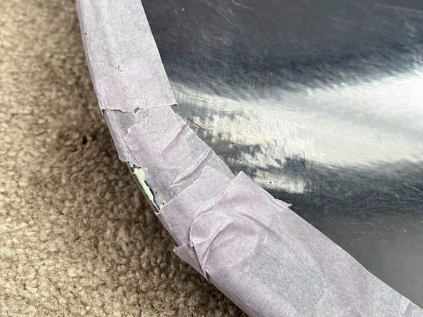

    • Apply painter's tape around the damaged edge, leaving the damaged edge exposed.
    • This will protect the board while sanding the damaged edge.
    • Always use painter's tape. Regular tape can be damaging to the boards outer coat.

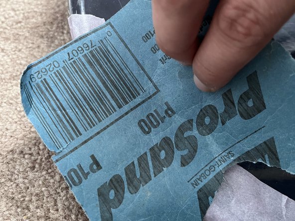

    • Sand out the chipped area so that the indent is smooth.
    • There should be no more rough edges where the chipped area is.
    • After your done sanding, make sure to clean away any leftover dust with warm water and a clean cloth.

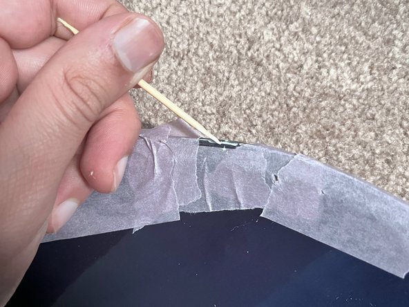

    • Squeeze out a little epoxy into the chipped area.
    • Use a toothpick to guide the epoxy into the crevasses.
    • The epoxy can be very hard to work with, be slow with it.
  5. How to fix a Chipped Snowboard Edge: crwdns2935265:05crwdnd2935265:01crwdnd2935265:01crwdne2935265:0
    • Clamp the chipped area to make sure it stays tight and compressed.
    • Let it stay clamped for 1-2 hours to allow the epoxy to harden.

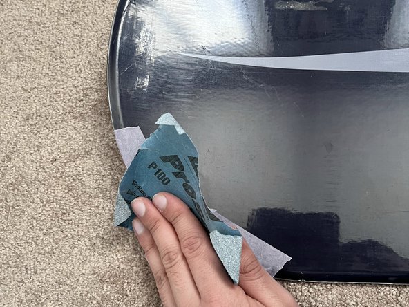

  6. How to fix a Chipped Snowboard Edge: crwdns2935265:06crwdnd2935265:01crwdnd2935265:03crwdne2935265:0 How to fix a Chipped Snowboard Edge: crwdns2935265:06crwdnd2935265:02crwdnd2935265:03crwdne2935265:0 How to fix a Chipped Snowboard Edge: crwdns2935265:06crwdnd2935265:03crwdnd2935265:03crwdne2935265:0
    • After the epoxy is hard, sand the excess epoxy until it's flush with the board.
    • Carefully and slowly remove the tape.
    • Allow the epoxy to cure for at least 24 hours before use.
    • A full cure is typically achieved between 24 hours and 7 days. Refer to your epoxy container for cure times.
Your snowboard should be good as new, test out your board after it the epoxy fully hardens.
