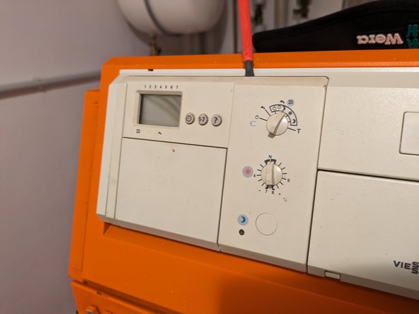

    • Locate the shutoff switch of your boiler and press it.
    • The switch is usually positioned right next to the flame-resistant door leading to the boiler room and labeled as Boiler Emergency Shutoff.
  2. How to dismount a Viessmann 7450156, Locate the HMI module: crwdns2935265:02crwdnd2935265:01crwdnd2935265:01crwdne2935265:0
    • Locate the HMI module of the Duomatik, that you want to remove.
  3. How to dismount a Viessmann 7450156, Loosen the HMI module: crwdns2935265:03crwdnd2935265:01crwdnd2935265:02crwdne2935265:0 How to dismount a Viessmann 7450156, Loosen the HMI module: crwdns2935265:03crwdnd2935265:02crwdnd2935265:02crwdne2935265:0
    Spudger
    $3.99
    • Insert a flathead screwdriver or a Spudger into the small notch on top of the module to gently loosen it.

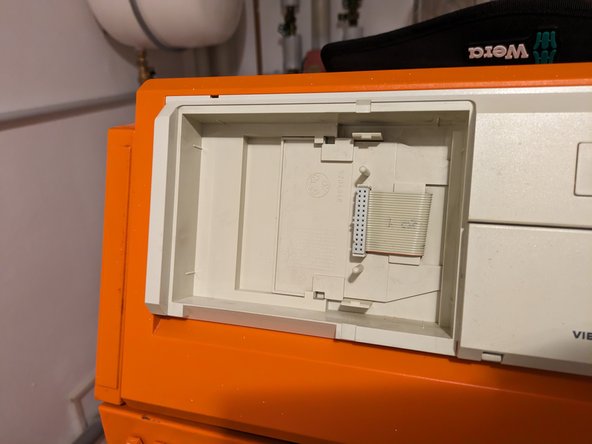

  4. How to dismount a Viessmann 7450156, Remove the HMI module: crwdns2935265:04crwdnd2935265:01crwdnd2935265:02crwdne2935265:0 How to dismount a Viessmann 7450156, Remove the HMI module: crwdns2935265:04crwdnd2935265:02crwdnd2935265:02crwdne2935265:0
    • Pull out the module straight toward yourself.
