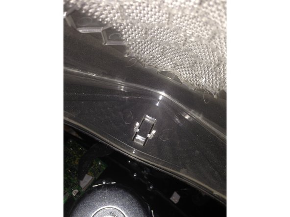

  3. How to disassemble a Bowers & Wilkins Zeppelin, Remove speaker grilles: crwdns2935265:03crwdnd2935265:01crwdnd2935265:02crwdne2935265:0 How to disassemble a Bowers & Wilkins Zeppelin, Remove speaker grilles: crwdns2935265:03crwdnd2935265:02crwdnd2935265:02crwdne2935265:0
    • Use a flat plastic tool or a blunt knife in the slot between the chrome bar and speaker cover to push the grille outward, while at the same time pressing the plastic fastener on the back side at the edge. USE CAUTION, the clips can break easily. Then slide the cover slowly to the side.
