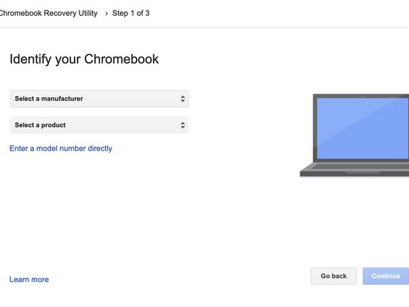

  2. How to create a Chrome OS Flex USB installer, Build your USB installer: crwdns2935265:03crwdnd2935265:01crwdnd2935265:03crwdne2935265:0 How to create a Chrome OS Flex USB installer, Build your USB installer: crwdns2935265:03crwdnd2935265:02crwdnd2935265:03crwdne2935265:0 How to create a Chrome OS Flex USB installer, Build your USB installer: crwdns2935265:03crwdnd2935265:03crwdnd2935265:03crwdne2935265:0
    • From Chrome, launch the Chrome Recovery Utility extension.
    • Click Get started
    • Click Select a model from a list
    • For the Select a manufacturer option, find and choose Google Chrome OS Flex.
    • For the Select a product option, find and choose Chrome OS Flex (Developer-Unstable).
