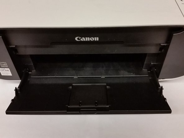

    • For safety ensure that the printer is powered off.
    • Lift the scanning unit until the scanning until support is vertical.
    • Lower the scanning unit until the scanning unit support seats in the scanning unit support slot.
  2. How to clear a Canon PIXMA MP190 paper jam, Step 2: crwdns2935265:02crwdnd2935265:01crwdnd2935265:02crwdne2935265:0 How to clear a Canon PIXMA MP190 paper jam, Step 2: crwdns2935265:02crwdnd2935265:02crwdnd2935265:02crwdne2935265:0
    • Locate the paper jam.
    • Firmly grasp the end of the paper that is most accessible.
    • Pull the jammed piece of paper from the printer evenly.
  3. How to clear a Canon PIXMA MP190 paper jam, Inspect Printer: crwdns2935265:03crwdnd2935265:01crwdnd2935265:01crwdne2935265:0
    • Inspect the printer thoroughly to ensure that all pieces of paper have been removed.
  4. How to clear a Canon PIXMA MP190 paper jam, Clean Paper Feed Rollers: crwdns2935265:04crwdnd2935265:01crwdnd2935265:01crwdne2935265:0
    • Scrub the paper feed roller using the detailing brush.
    • The roller can be rotated manually so the entire surface of the roller can be cleaned.
  5. How to clear a Canon PIXMA MP190 paper jam, Restore Functionality: crwdns2935265:05crwdnd2935265:01crwdnd2935265:02crwdne2935265:0 How to clear a Canon PIXMA MP190 paper jam, Restore Functionality: crwdns2935265:05crwdnd2935265:02crwdnd2935265:02crwdne2935265:0
    • Lift up the scanning unit and press the scanning unit support inward while lowering the scanning unit.
    • The printer is now ready to print.
