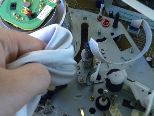

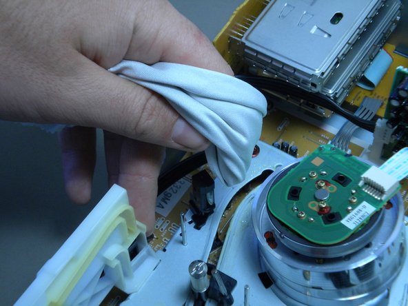

    • Before cleaning the VCR heads, be sure that the front of the device is facing you with the top cover removed.
    • Locate the two VCR heads highlighted in by the blue boxes in image one.
    • GENTLY clean heads with a microfiber rag and a cleaning solution of your choice.
