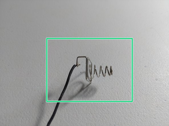

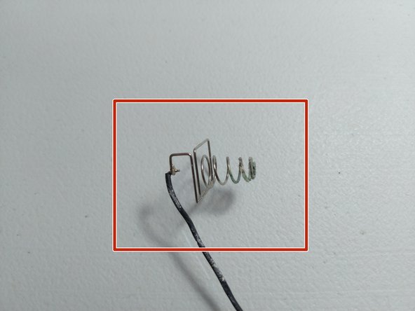

  4. How to clean up a battery leakage, The power cable: crwdns2935265:04crwdnd2935265:01crwdnd2935265:03crwdne2935265:0 How to clean up a battery leakage, The power cable: crwdns2935265:04crwdnd2935265:02crwdnd2935265:03crwdne2935265:0 How to clean up a battery leakage, The power cable: crwdns2935265:04crwdnd2935265:03crwdnd2935265:03crwdne2935265:0
    • Completely remove the power cable.
    • You will clean it using a homemade chemical solution composed of vinegar and salt. The same solution used to clean old coins.
    • On a mall cup of tea add vinegar until it almost fill up and add a small tea spoon of salt and mix it up until the salt dissolve.
    • Drop the contained metallic part inside the solution and wait for about 10 minutes.
    • Remove it and check if the corrosion was removed. If not repeat the process for more 10 minutes. Dot not forget the metal inside the solution for a time longer than10 minutes or the solution will star to corrode the metal and make things worse.
    • Finish it by cleaning it with a tooth brush and alcohol isopropyl.
    • Before clean.
    • After clean
