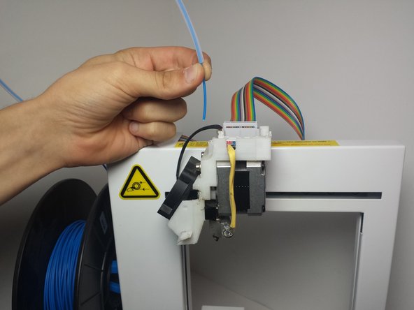

  3. How to clean the UP! Plus 2 gearbox, Removing the Filament: crwdns2935265:03crwdnd2935265:01crwdnd2935265:03crwdne2935265:0 How to clean the UP! Plus 2 gearbox, Removing the Filament: crwdns2935265:03crwdnd2935265:02crwdnd2935265:03crwdne2935265:0 How to clean the UP! Plus 2 gearbox, Removing the Filament: crwdns2935265:03crwdnd2935265:03crwdnd2935265:03crwdne2935265:0
    • Set up the printer as you would use it normally by connecting the USB cable from the rear of the printer to your computer and then turning it on.

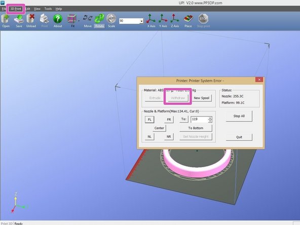

    • Once connected to your computer bring up the included up software and click 3D print at the top and select Maintenance. Under the new maintenance window, click withdraw.
    • Wait for the printer to beep to indicate it has fully withdrawn the plastic before you remove the remaining end from the extruder assembly.

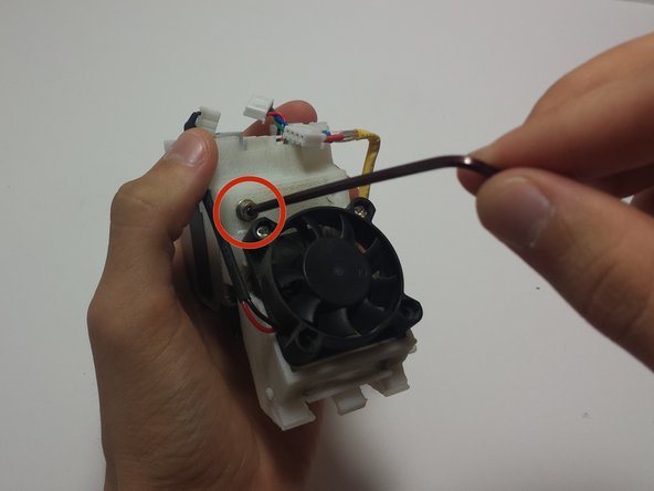

    • With the 2.5mm hex tool unscrew the two small hex screws immediately above the top left and right corners of the fan.
    • You do not need to unscrew the fan or unplug the fan connector.

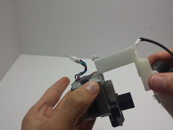

  7. How to clean the UP! Plus 2 gearbox, Separate Stepper Motor: crwdns2935265:07crwdnd2935265:01crwdnd2935265:02crwdne2935265:0 How to clean the UP! Plus 2 gearbox, Separate Stepper Motor: crwdns2935265:07crwdnd2935265:02crwdnd2935265:02crwdne2935265:0
    • Once the two screws have been removed the entire plastic body, with fan and connector board, should be able to slide off of the stepper motor by pulling the plastic assembly towards you.

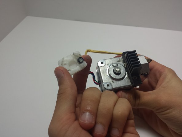

  8. How to clean the UP! Plus 2 gearbox, Remove Gear Box: crwdns2935265:08crwdnd2935265:01crwdnd2935265:02crwdne2935265:0 How to clean the UP! Plus 2 gearbox, Remove Gear Box: crwdns2935265:08crwdnd2935265:02crwdnd2935265:02crwdne2935265:0
    • Remove the small white plastic gearbox at the base of the stepper motor.
    • Check for any ground down gear teeth or signs of excessive wear.

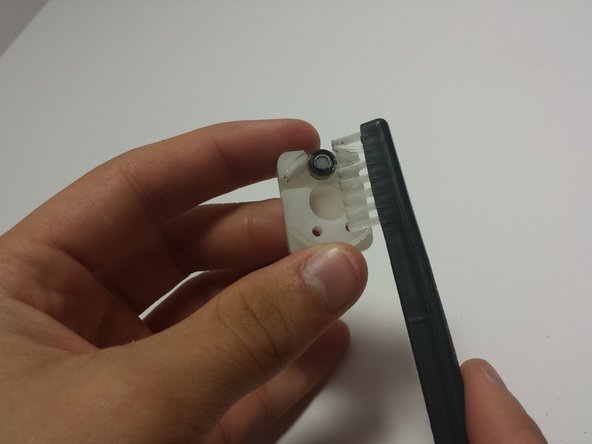

  9. How to clean the UP! Plus 2 gearbox, Clean The Stepper Motor Gear: crwdns2935265:09crwdnd2935265:01crwdnd2935265:02crwdne2935265:0 How to clean the UP! Plus 2 gearbox, Clean The Stepper Motor Gear: crwdns2935265:09crwdnd2935265:02crwdnd2935265:02crwdne2935265:0
    • Clean the stepper motor gear by brushing it with a fine stiff brush and ensure that all of the plastic remnants and dust have been removed.
    • If needed, use q-tips dipped in rubbing alcohol (higher percentage the better) to swab out the remaining particles left over.
