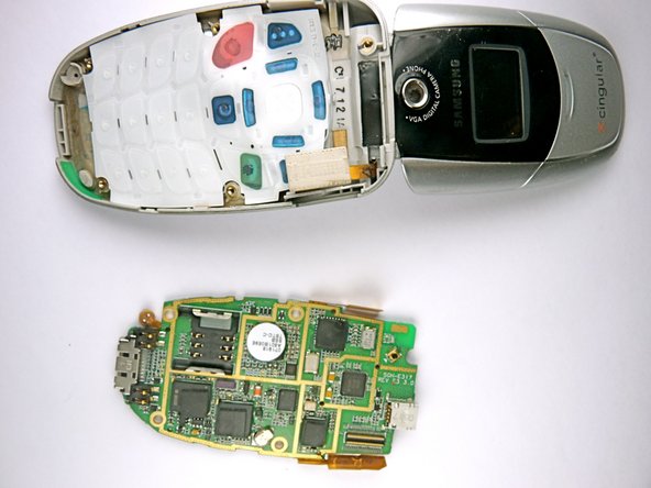

  6. How to clean the Samsung SGH-E317 keypad: crwdns2935265:06crwdnd2935265:01crwdnd2935265:01crwdne2935265:0
    • With the back panel removed, the motherboard should be fully exposed.
  7. How to clean the Samsung SGH-E317 keypad: crwdns2935265:07crwdnd2935265:01crwdnd2935265:02crwdne2935265:0 How to clean the Samsung SGH-E317 keypad: crwdns2935265:07crwdnd2935265:02crwdnd2935265:02crwdne2935265:0
    • Remove the camera and volume buttons and place them in a safe spot until reassembly.

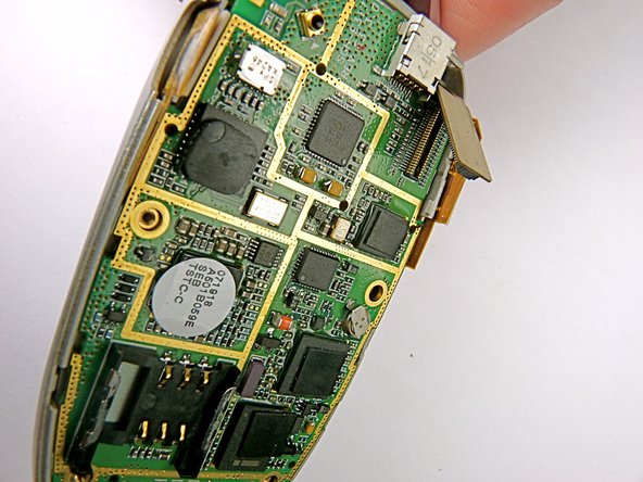

  8. How to clean the Samsung SGH-E317 keypad: crwdns2935265:08crwdnd2935265:01crwdnd2935265:02crwdne2935265:0 How to clean the Samsung SGH-E317 keypad: crwdns2935265:08crwdnd2935265:02crwdnd2935265:02crwdne2935265:0
    • Using a plastic opening tool, unplug the ribbon cable connecting the front LCDs to the motherboard.
  9. How to clean the Samsung SGH-E317 keypad: crwdns2935265:09crwdnd2935265:01crwdnd2935265:02crwdne2935265:0 How to clean the Samsung SGH-E317 keypad: crwdns2935265:09crwdnd2935265:02crwdnd2935265:02crwdne2935265:0
    • Detach the motherboard by grabbing the edges of it and lifting it straight out of the phone.
  10. How to clean the Samsung SGH-E317 keypad, How to clean the Samsung SGH-E317 keypad: crwdns2935265:010crwdnd2935265:01crwdnd2935265:01crwdne2935265:0
    • After removing motherboard, the phone will look like this.

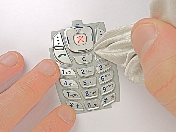

  11. How to clean the Samsung SGH-E317 keypad: crwdns2935265:011crwdnd2935265:01crwdnd2935265:01crwdne2935265:0
    • Grab the corner of the rubber key pad and lift out slowly.
  12. How to clean the Samsung SGH-E317 keypad: crwdns2935265:012crwdnd2935265:01crwdnd2935265:02crwdne2935265:0 How to clean the Samsung SGH-E317 keypad: crwdns2935265:012crwdnd2935265:02crwdnd2935265:02crwdne2935265:0
    • By using a small standard screwdriver and a fine, thin, soft cloth you can clean in between the keypad to remove dirt and debris.
