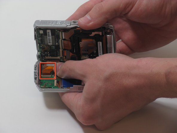

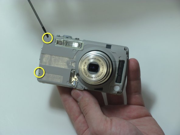

  5. How to clean the Olympus Stylus 760 lens and sensor: crwdns2935265:05crwdnd2935265:01crwdnd2935265:03crwdne2935265:0 How to clean the Olympus Stylus 760 lens and sensor: crwdns2935265:05crwdnd2935265:02crwdnd2935265:03crwdne2935265:0 How to clean the Olympus Stylus 760 lens and sensor: crwdns2935265:05crwdnd2935265:03crwdnd2935265:03crwdne2935265:0
    • Remove the 2 screws on the right side of the camera.
    • Remove the 2 screwson the left side of the camera
    • CAUTION! Circuit ribbon is attached at the top left of the camera be careful when separating the front and back of the camera after removing the 4 screws.
  6. How to clean the Olympus Stylus 760 lens and sensor: crwdns2935265:06crwdnd2935265:01crwdnd2935265:01crwdne2935265:0
    • Carefully flip up the clip attaching the ribbon from the rear to the front and pull it out
  7. How to clean the Olympus Stylus 760 lens and sensor: crwdns2935265:07crwdnd2935265:01crwdnd2935265:01crwdne2935265:0
    • Carefully separate the front and back of the camera
  8. How to clean the Olympus Stylus 760 lens and sensor: crwdns2935265:08crwdnd2935265:01crwdnd2935265:01crwdne2935265:0
