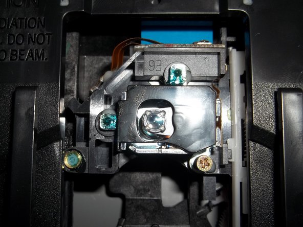

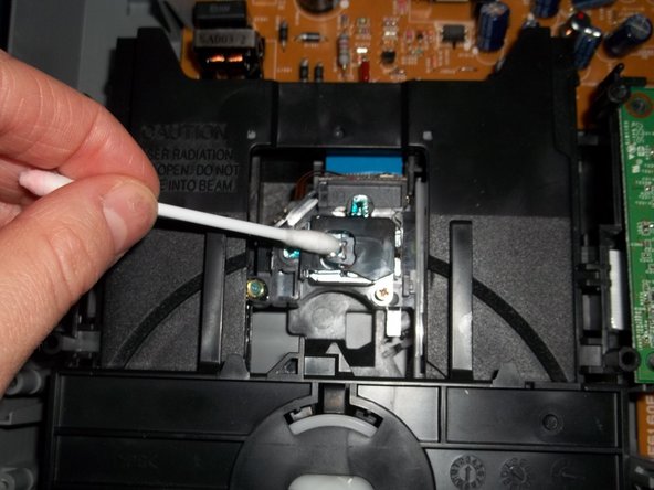

  5. How to clean the Magnavox MWD200F optical lens, How to clean the Magnavox MWD200F optical lens: crwdns2935265:05crwdnd2935265:01crwdnd2935265:03crwdne2935265:0 How to clean the Magnavox MWD200F optical lens, How to clean the Magnavox MWD200F optical lens: crwdns2935265:05crwdnd2935265:02crwdnd2935265:03crwdne2935265:0 How to clean the Magnavox MWD200F optical lens, How to clean the Magnavox MWD200F optical lens: crwdns2935265:05crwdnd2935265:03crwdnd2935265:03crwdne2935265:0
    • Locate the optic lens in the middle of the disc drive. Dip a cotton swab in rubbing alcohol and use it to lightly wipe the lens. After the lens is clear of dust and debris, wait a few minutes to let it air dry.
