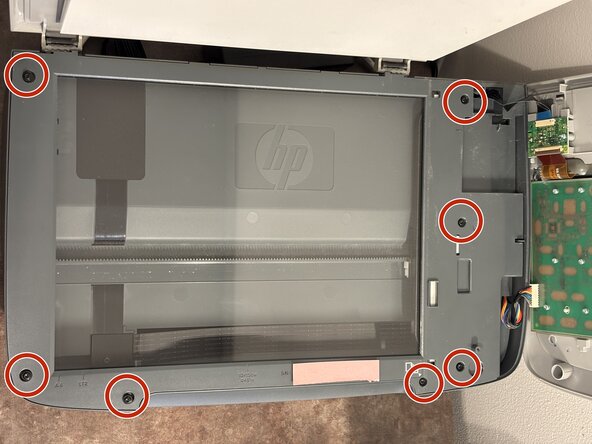

  3. How to clean the HP Photosmart 2575 All-in-One's scanner glass, How to clean the HP Photosmart 2575 All-in-One's scanner glass: crwdns2935265:03crwdnd2935265:01crwdnd2935265:02crwdne2935265:0 How to clean the HP Photosmart 2575 All-in-One's scanner glass, How to clean the HP Photosmart 2575 All-in-One's scanner glass: crwdns2935265:03crwdnd2935265:02crwdnd2935265:02crwdne2935265:0
    • Remove seven T10 screws.

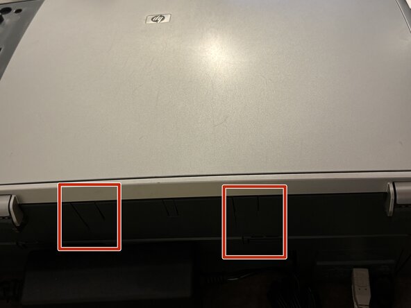

    • Unhook the two larger clips on the back side. Do not unhook the smaller clip as it will detach the glass pane.
    • Begin lifting up the panel with the scanner glass by lifting up the two large clips. Be careful as the glass pane is not secured very well.
    • Wipe dust from the underside and the upper side of the glass pane using a microfiber cloth.
