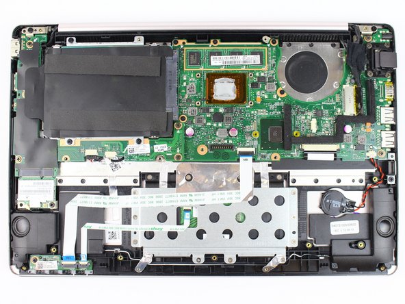

    • Use a Phillips 0 screwdriver to remove nine Phillips screws from the back of the laptop (four 7mm from the top hinge, four 5mm from the bottom hinge, and one 10mm screw from the center).
  2. How to clean the CPU fan on Asus VivoBook Q200E-BHI3T45: crwdns2935265:02crwdnd2935265:01crwdnd2935265:01crwdne2935265:0
    • Use a plastic opening tool to pry the back panel off.
  3. How to clean the CPU fan on Asus VivoBook Q200E-BHI3T45: crwdns2935265:03crwdnd2935265:01crwdnd2935265:02crwdne2935265:0 How to clean the CPU fan on Asus VivoBook Q200E-BHI3T45: crwdns2935265:03crwdnd2935265:02crwdnd2935265:02crwdne2935265:0
    • Use a Phillips 0 screwdriver to remove the eight 5mm Phillips screws holding the battery in place.
  4. How to clean the CPU fan on Asus VivoBook Q200E-BHI3T45: crwdns2935265:04crwdnd2935265:01crwdnd2935265:02crwdne2935265:0 How to clean the CPU fan on Asus VivoBook Q200E-BHI3T45: crwdns2935265:04crwdnd2935265:02crwdnd2935265:02crwdne2935265:0
    • Remove the ribbon cable with a pair of tweezers.
  5. How to clean the CPU fan on Asus VivoBook Q200E-BHI3T45: crwdns2935265:05crwdnd2935265:01crwdnd2935265:01crwdne2935265:0
    • Lift and remove the battery.
  6. How to clean the CPU fan on Asus VivoBook Q200E-BHI3T45, Fan: crwdns2935265:06crwdnd2935265:01crwdnd2935265:01crwdne2935265:0
    • Gently peel off the tape from the fan.
  7. How to clean the CPU fan on Asus VivoBook Q200E-BHI3T45: crwdns2935265:07crwdnd2935265:01crwdnd2935265:02crwdne2935265:0 How to clean the CPU fan on Asus VivoBook Q200E-BHI3T45: crwdns2935265:07crwdnd2935265:02crwdnd2935265:02crwdne2935265:0
    • Remove five 5mm screws using a Phillips 0 screwdriver.
    • Remove the two 2mm screws with a Phillips 000 screwdriver.
  8. How to clean the CPU fan on Asus VivoBook Q200E-BHI3T45: crwdns2935265:08crwdnd2935265:01crwdnd2935265:01crwdne2935265:0
    • Disconnect the fan's power cable by pulling upward on the pin connector with a pair of tweezers.
  9. How to clean the CPU fan on Asus VivoBook Q200E-BHI3T45: crwdns2935265:09crwdnd2935265:01crwdnd2935265:02crwdne2935265:0 How to clean the CPU fan on Asus VivoBook Q200E-BHI3T45: crwdns2935265:09crwdnd2935265:02crwdnd2935265:02crwdne2935265:0
    • Grab the sides of the fan assembly and remove it by lifting upwards.
  10. How to clean the CPU fan on Asus VivoBook Q200E-BHI3T45, How to clean the CPU fan on Asus VivoBook Q200E-BHI3T45: crwdns2935265:010crwdnd2935265:01crwdnd2935265:01crwdne2935265:0
    • Remove the tape connected to the fan covering plate.
  11. How to clean the CPU fan on Asus VivoBook Q200E-BHI3T45: crwdns2935265:011crwdnd2935265:01crwdnd2935265:01crwdne2935265:0
    • Gently pull the covering plate from the covering tab.
  12. How to clean the CPU fan on Asus VivoBook Q200E-BHI3T45: crwdns2935265:012crwdnd2935265:01crwdnd2935265:01crwdne2935265:0
    • Remove the covering plate.
  13. How to clean the CPU fan on Asus VivoBook Q200E-BHI3T45: crwdns2935265:013crwdnd2935265:01crwdnd2935265:02crwdne2935265:0 How to clean the CPU fan on Asus VivoBook Q200E-BHI3T45: crwdns2935265:013crwdnd2935265:02crwdnd2935265:02crwdne2935265:0
    • From the back, push the fan out of the motor.
    • Clean the fan using a damp cloth, and allow to dry.
